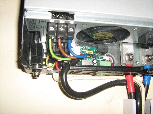

If I had to find fault it would be minor issues, the cable entry for the 230v supply in and supply out don't have strain relief for the cables, the termination blocks are a bit fiddly and awkward as well, it took a couple of termination attempts on one of the wires before it was satisfactory. It's located at head height in my office less that a meter away from me when I'm sitting and the fan is a bit on the noisy side. It's not a poor quality issue it's just the volume of the air movement. Thankfully it only runs during power outages and 2 or 3 hours after during battery recharging. Once the batteries are charged the fan is completely off all the time.

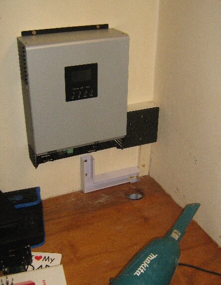

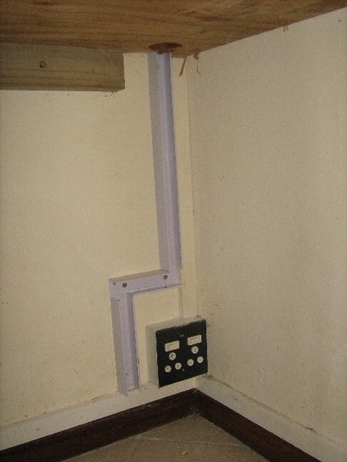

I realise it's not going to win any awards but here's some pictures of the 3kW unit with 4x 225Ah batteries I installed in my home office;

The connection points on your one are a lot more accessible than the out back and we had no end of trouble with the internal GFI , and ended up removing it in the end .
You should get those battery terminals covered up , and be careful with any gasses given off as it looks like it is inside your house !?
I'm not sure about GS83/2 compliance Gavin. Would it be required for an installation that's basically set up as a UPS and doesn't export into the grid?
Thanks for your concerns JD,the installation was a bit neater before I started playing with it to test it's capabilities. It does have a battery cover that's removed at the moment. The office is fairly well vented, it would be well over the 2 air changes per hour which the ASHRAE regs suggest.
