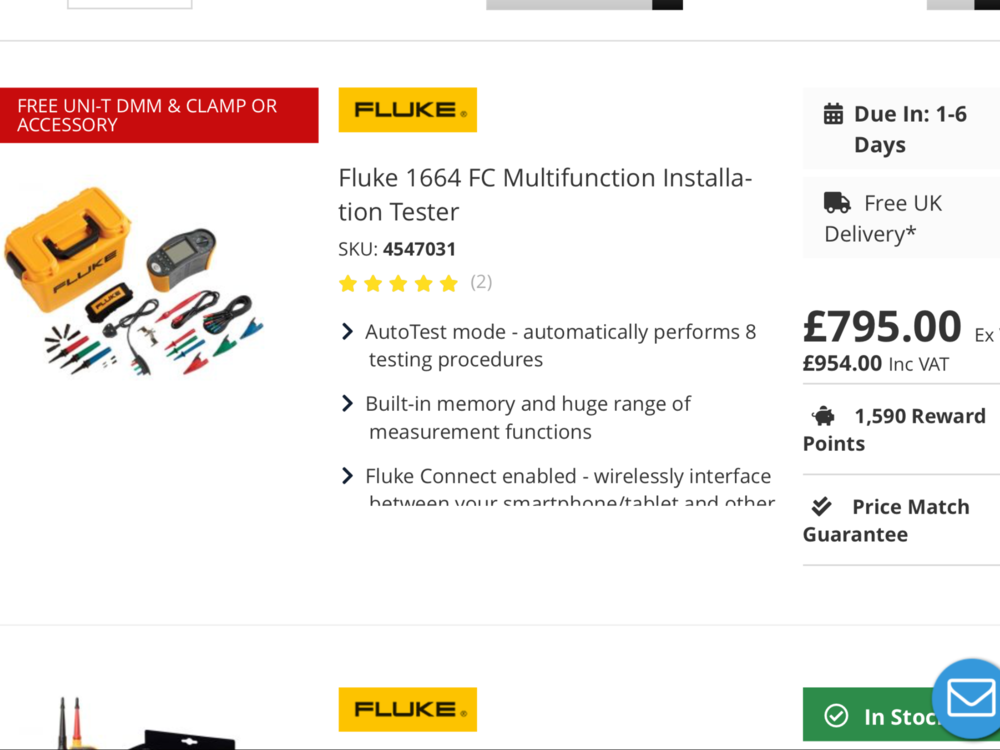

This is the right equipment:

Do not use a 'volt pen' for testing isolation, they are a rough guide at best and not suitable for testing.
I don't know if that is correct or not as I have not seen your installation and do not know how it is wired, there are many ways to wire a lighting circuit and whilst it is likely that there is one black switched live I cannot guarantee this.
Without a continuity tester and the knowledge to use it it is not possible to identify the cables safely and without making them live.
[automerge]1580892383[/automerge]
That's ridiculously over the top for identifying a few cables to replace an existing light fitting.
