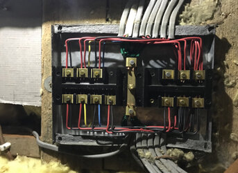

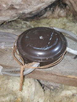

Back in the distant past, domestic lighting circuits used humungeous junction boxes where all of the switches and light fittings joined. Usually there was one hidden under the floor of the landing / for the ground floor lights. The upstairs box was in the loft.
Known as Octopus boxes. They were such fun. Here’s an example

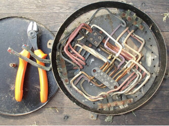

Another type
Another type

is the top pic. lead sheathed cable, with them being clamped with a metal cpc band. If so, I'd age that 1920s - 30s.
What era are we talking?
Most of 20th century up to about mid 1960’s. You’ll notice from the pix above that no earth is provided and that wasn’t introduced for lighting circuits until 1966.
At that point (I guess) an Octopus became unwieldy as you might have a large number of earth wires to common up in one box.
What seems to have happened is that electricians took to the round junction boxes. These were mostly 3-terminal, leaving no place for the earths but the sparks used to just twist the earths together outside the box!

If there is just a single cable at the light, first thing to check for is if a handful of connector block isn't shoved in the ceiling or in the call just above / behind the light. Very very common to find this in domestic settings
