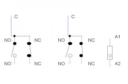

Right guys im looking for a 100amp Contactor that can be supplied with 2 inputs to 1 output these will be switched via the A1,A2 terminals from a timer.
Now i would have thought such a simple device would exist but im unable to locate.
Below is a drawing of what i would be looking for.
[ElectriciansForums.net] Information Required... Switch Over Contactor
Now i know i could build this using 2 contactors but i was looking for a single device for a small and easy install.
Any help appreciated
What I have used in the past is a contactor with 2X NO + 2X NC contacts, and commoning one side of NO with one side of NC
contacts, (do this twice, again on the other pair) will give you a 2X C/O.
