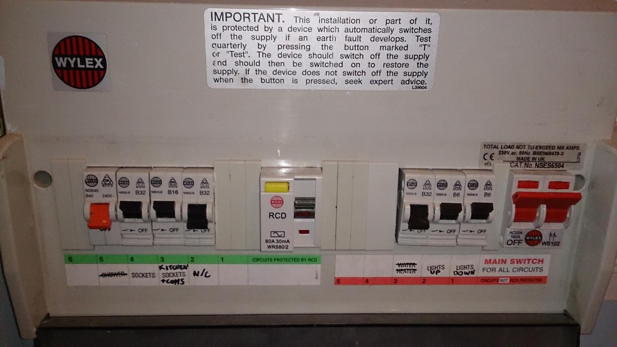

I've got a 16th edition Wylex board:
RCD-protected side:
2: Spare (32A)
3: sockets (kitchen+consevatory), 32A type B 60898 RFC 2.5+1.5 T&E
4: sockets (except kitchen + conservatory), 32A type B 60898 RFC 2.5+1.5 T&E
5: Shower (disconnected at isolator, replaced with boiler-fed shower), 40A
Non-RCD-protected side:
1: lights down+doorbell+porch light (spur at board), 6A type B 60898 RFC 1.5+1.0 T&E
2: lights up, 6A type B 60898 RFC 1.5+1.0 T&E
3: Water heater (disconnected), 16A
Ze = 0.10, Ipf 2.3kA, TN-C-S

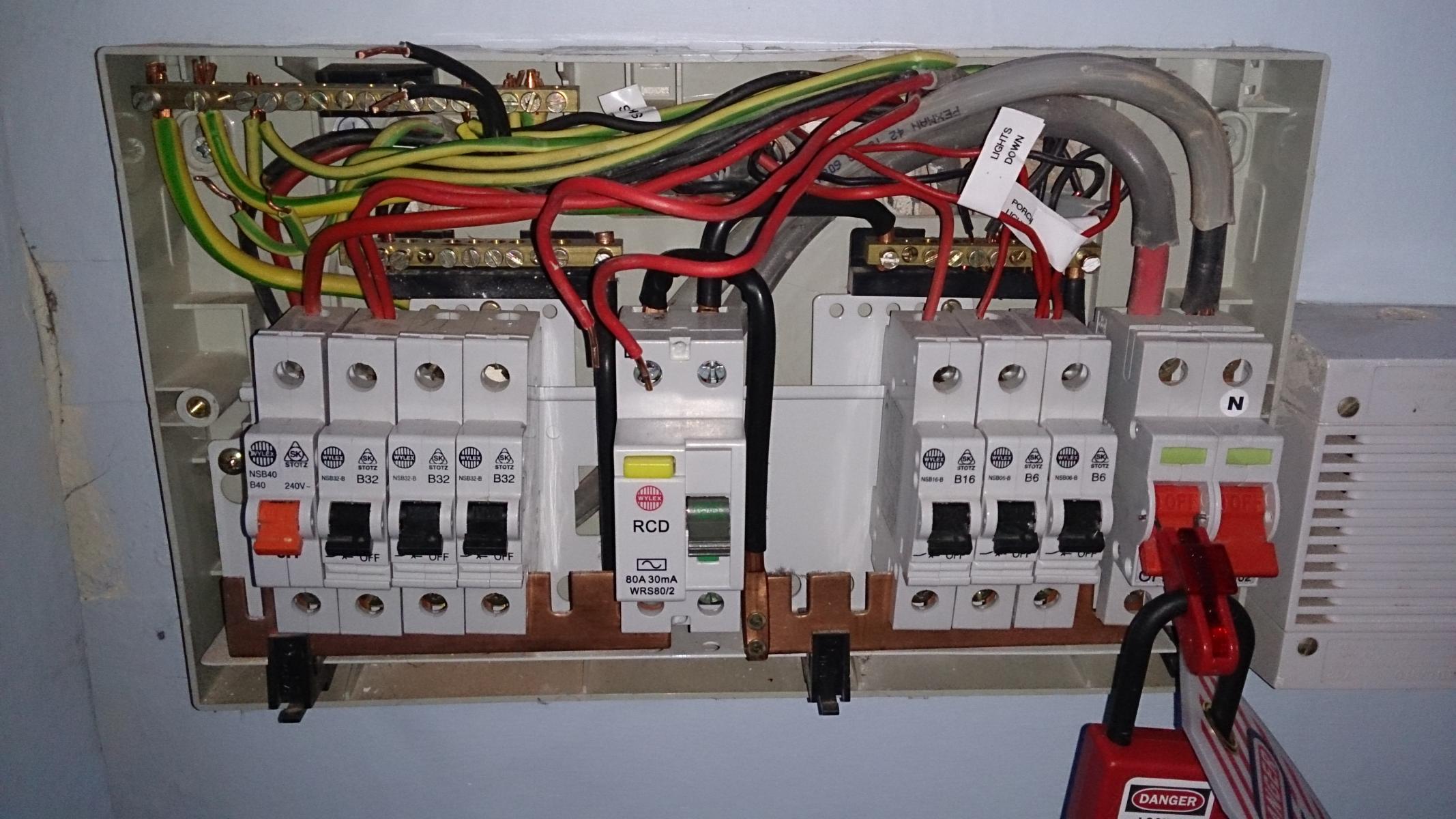

I did some non-trip Zs measurements on the two RFCs. Circuit 4 looked fine and dandy: consistent readings through the house, between about 0.42 ohms and 0.50 ohms, except a couple that look like they might be spurs where it creeps up to 0.63/0.64 ohms - funnily enough, both of these are surface-mounted boxed, as opposed to recessed into the plaster. Then on dead tests, r1, rn and r2 all about right: 0.59, 0.60 and 0.97 respectively. R1+R2 followed nicely, between 0.31 and 0.42. All good :)
Circuit 3, however, is broken. Literally, as in, it's not a ring. Measured Zs reflected this: starts low at the end of the kitchen closest to the DB, (0.35 ohms), one of the kitchen sockets reads 1.35 ohms which is an anomaly, and Zs creeps up in the conservatory through 0.54 to 0.69.
r1, rn and r2 all show no continuity.
So I got my long lead out. Interestingly, one socket in the kitchen (on the wall closest to the DB) is on leg "A", whilst all the other stuff is on leg "B".
Will it surprise anyone that we had our kitchen done recently? :) I have left a message on the answerphone of the company that did the electrical work, I will give them the opportunity to put it right.
As a temporary measure, I have also swapped the 32A MCB for the 16A one that used to supply the water heater. Guess I'll have to avoid boiling the kettle when the oven's on.
That was as much time as I had before I had to pack up in preparation for picking up my son.
Some pictures:
Not the neatest installation, is it? A busbar cover would make me more comfortable, too.
Back together, the split ring now on a 16A MCB.

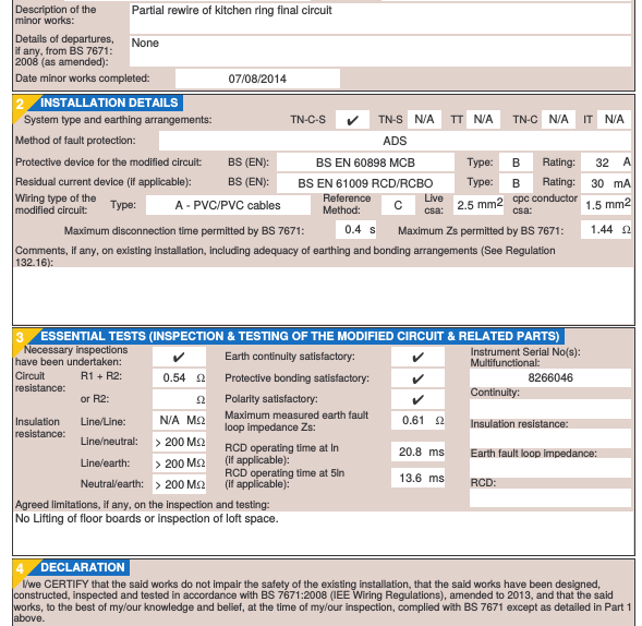

Work of fiction: entirely! Either the R1+R2 value on the MEIWC is made up, leaving a potentially dangerous installation (which I would give a C2 on an EICR - would that be right?), or, he was the bugger who twisted the RFC CPCs together in the MET. Not sure which is the greater crime... ;)
We're going to have words...
Remember he could claim that the Zs value is OK because it is 30mA RCD protected so Zs only needs to be less than 1667Ω. But this is not really acceptable as you can easily have the circuit compliant.
However the potential overload of the cable on the long length of the leg, especially in a kitchen, would be more difficult to prevent attracting a C2.
You could almost bet that the circuit was tested at a single point for Zs and R1+R2 back calculated from Zs at the board, though you do not have to have R1+R2 on the MEIWC (Only Zs).
Agreed. And on the standard IET MEIWC you're right, this NICEIC Domestic Installer used a different form, though. I have cropped it to remove my and the installer's personal info.
Edit (extra stuff): As for Zs - I think this is satisfactory anyway for the MCB (regardless of presence of RCD), despite being on two radials (I have a low Ze, it was apparently 0.07 ohms in August, I measured it at 0.10 ohms on Tuesday). No, what was bothering me is the overload situation, especially since I (potentially) have a double oven, a kettle and a microwave all on the same leg - I say potentially as I didn't take the cover off the oven switch to determine what leg it was on.
The 1.35 would not make it on the anomalous socket as that would then be a calculated Zs of 1.42Ω at 20°C with a limit of 1.16Ω.

On a practical basis there is small cause for concern but from a compliance basis this is terrible, if you did not have additional sockets added then it is likely that there is a missing cable connection at one socket (or that they damaged the cable between two sockets and so left it out!)
