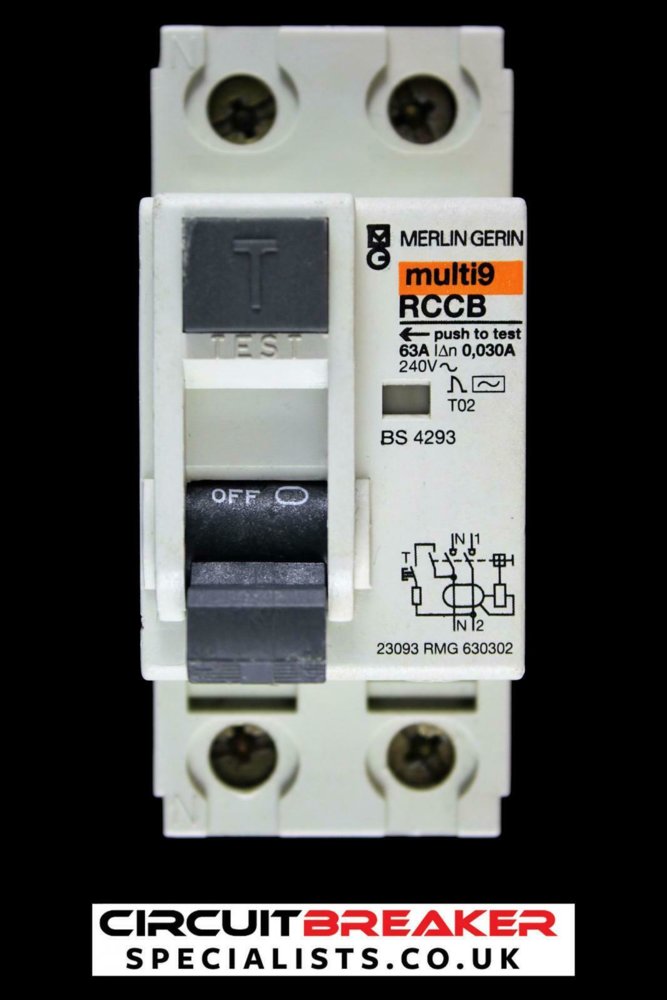

Hello,
We live in an old stone built ground floor flat, built in the 1880s. Obviously the consumer unit and cabling has been updated a number of times over the years by previous owners. One being the Local Authority who owned the property back in the 1960s -70s.
We have lived here for 25 years and decided to have an electrical inspection carried out by a local Electrician. He is a good honest guy, fully trained and qualified and a member of quite a few registered bodies. His report has shown only a couple of problem areas that should be addressed. Separate circuits for appliances, swapping circuits to the protected side of the consumer unit, updating sockets and light switches. He says although our consumer unit is older and the cabling is older there is no need change it or renew at this time but it is something we should think about for the future. He did have limited knowledge with regard to our particular make/model of consumer unit. (Young guy probably not born when our consumer unit was installed)
Now, our plan is to sell up in the new year and realising that this would be a huge upheaval and at a hefty cost we have decided to not take on the task.
However, we have hit a juncture. Our plumbing is such that we have only ever had an Electric Shower.
We wish to maintain this arrangement but have decided to upgrade the shower to a more powerful 10.5Kw unit as the old 7.5Kw shower has packed in and as you have no doubt guessed, this will involve a cable and MCB upgrade.
Existing arrangement is; distance from consumer unit to shower, 25m. Cabling 6mm², under floor in solemn space and in plaster for the last 1m. 32amp MCB on RCD protected circuit.
Our fuse box is an Merlin Gerin, (photos attached).
My questions are; (bearing in mind we are not changing the consumer unit and only wish to change the cabling and MCB for this one circuit),
Q1, would the Merlin Gerin consumer unit be able to be upgraded with a modern Schneider Acti9 45 amp MCB in place of the Multi9 MCB.
Q2, Are our current Multi9 MCBs a C-curve? I'm not sure if the writing on the current MCBs indicate the Curve type.
Q3, Would the Schneider replacement MCBs need to be a C-Curve or B-Curve type in whichever case?
Q4, Rather than a consumer unit upgrade, could we actually just update all the MCBs in the consumer unit this way?
Q4, Should we upgrade all the MCBs to RCBOs instead. (Assuming there is room in the consumer unit for such an upgrade as I understand they are quite large in comparison).
From my internet of things investigation... I gather that Merlin Gerin are no longer in manufacture and subsequently that the proper replacement for Multi9 would be Schneider Acti9. Would this be the correct information?
Any good advice appreciated for 3 dirty children and a smelly wife... I've always been a clean guy...

As already mentioned, a 'Satisfactory' EICR with no Insulation Resistance readings??!
Also, is this a TN-S or TT, under the Inspection page the box for Earth Electrode has as 'Pass' marked down.
Retrospectively there is nothing wrong with this consumer unit. Out of curiosity, how long did the Electrician take to complete the EICR??

You've already posted a picture showing what appears to be a TNS supply (though a better picture would confirm) so this question just seems daft?

Q6: In one of the CU photos, you can see a shared outgoing, a partially white painted cable heading off upward to the flat upstairs for approx 8-10m, What impact would this have on the IR, Ze and PFC testing, in particular for the incoming origin OPD of the installation?
I am going to assume this is a DNO shared supply and not privately fed from your installation?
No effect on the testing, it appears to be unsecured from what i can see so may attract a comment about that.
