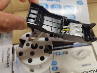

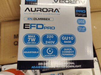

I'm changing a couple of rooms from 12v halogen gu5.3 to 230v LED light fittings.

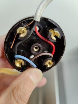

There currently is this round connector linked to the live & neutral of the old 12v transformer.
[ElectriciansForums.net] Installation help UK
My new LED light fittings have an earth connection too. So can I just directly connect the earth, black and red wires directly to the new light fitting, or is there a good reason to run a new piece of cable between the round connector and the new light fitting?
If connecting directly, and removing the round connector entirely, will that earth cable need a shielding sleeve to cover the bare wire when connecting to the light fitting?[ElectriciansForums.net] Installation help UK
Yes..
Take off the round joint box. The push in connectors of the light fitting are designed for solid core conductors, which is what the red/black are.
A little bit of green/yellow sleeving on the bare earth wire, which should have been there already.
Make the red/black as short as possible(2-3cm). The box lid should be able to fold over, clip shut and actually grip the grey outer sheath of the cable.
Yes..
That's great, thank you mate 👍
Yeh, I did wonder about that long length of bare earth wire... Seemed a bit of a casual installation.
A task that would be much easier if the designers of these things left a sensible distance between clamp and terminals!
Put them on site, fitting a few, and the design would soon improve.
