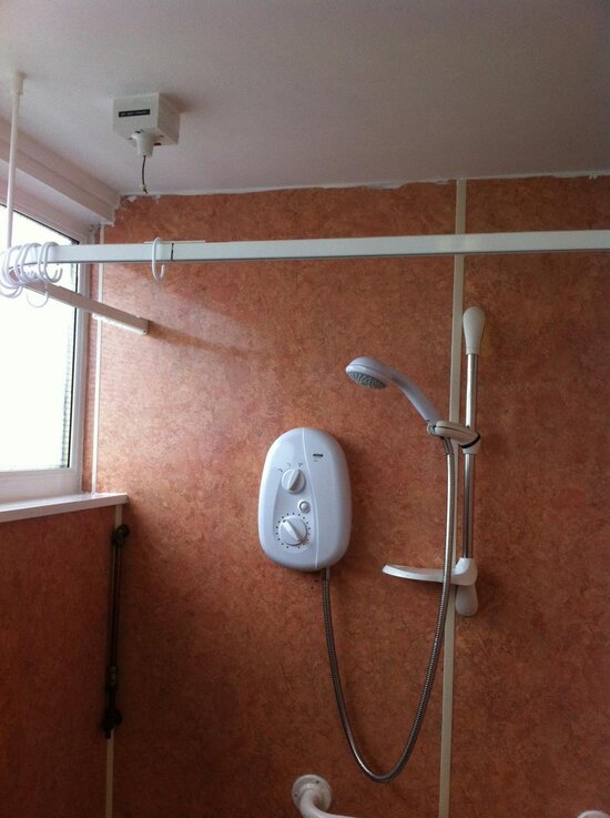

Found a shower pull cord switch within zone 1 of a shower. Can't tell the manufacturers details so can't ask them. So does anyone know what the general rating for these switches are? (Thought I saw something posted on here once, possibly by Spin?).
Either way not a great installation and it was like this on 4 showers.
Here's a piccy:[ElectriciansForums.net] IP rating of shower pull cord
My understanding, is that MK ceiling accessories are only IP3X, as such not suitable for positioning anywhere in the zones, and not recommended for positioning where they would be subjected to excessive moisture or dampness.
Even if the ceiling is 2.25m above floor level, I wouldn't consider placing the accessory directly above zone 1 a good idea.
Which is why i always use a wall switch on the shower installs i do.
total faff to wire up pullcords regardless of where they are , and i've lost count of the ones that have burnt out.
Also to note is the shower switch is a functional means of isolation that should be able to be used of which is clearly not as its out of reach in its short string state, question is do you put the string on and class it as a zone 1 violation ;)..... wet moisture laden string all the way up to a damp live switch :6:
The pull cord switch needs to be IPx4 rated or above, but does such a thing exist? I checked with MK today & they don't make one. Does anyone out there know of one? Would make my life a lot easier.
The pull string needs to move in and out of the pull switch i fear it isnt possible to acheive IP4X because of this but good look trying to find one.
