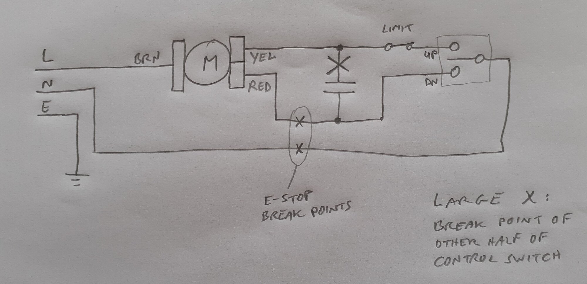

A friend bought an extra control switch for his winch so that he'd have controls at upper and lower levels during building work. His problem was that the new switch was single pole while the switch in the original control unit was double pole (both double throw, centre return).
However, the outputs of the "extra" pole on the control switch were linked together meaning that whichever way the rocker was switched, it was connected in exactly the same way so that it's only purpose appeared to be to produce a break in the circuit when the switch was in its centre (off) position.
This break was produced in series with a capacitor which spanned the two motor coils (see picture).
My question is: Is this circuit break necessary? The way I see it, when the unit is not in use, there'll be 240v at both sides of the capacitor (through the two motor windings), so the cap will be inert (won't it?), while the motor circuit is still dead because of the control switch position.
[ If the motor windings are asynchronous (a distinct possibility in a winch) could this produce a potential difference across the cap? ]
So, yes, my question is re the necessity of this "extra" pole on the original control switch since, if it's NOT required, the job of fitting the new (single pole) switch is simple. Although one wonders why this extra expense would be added if it wasn't required...

Someone has gone to the trouble of designing the circuit and making use of the other pole on the switch, therefore it must be needed.
Do both poles of the switch make and break at exactly the same time?
My guess would be it's to do with braking.
You say the other switch pole breaks the capacitor circuit at X when stopped, so there won't be 240 either side.
Yes, it's two poles on one switch.
Surely, since live is hardwired to common on the motor, and there is no closed circuit, then there'd be no voltage drop across the motor's windings...?
