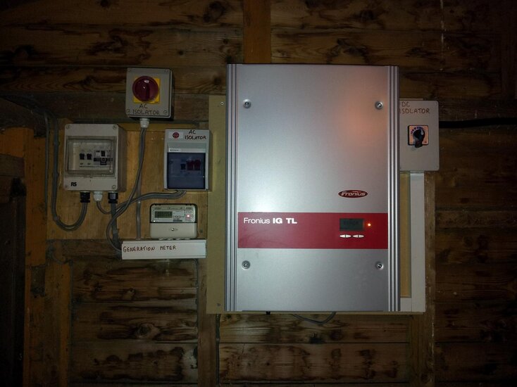

Hello everyone, this is my first post. I'm not an electrician, but I'm really in need of one, it seems! I have had a 4KW solar array installed to supply my home. It's ground mounted in the field next to our garden so is quite some distance from the house. The installer has put the inverter, the isolators, the generation meter etc in a wooden stable building in the field, which already had a (rarely used) electricity supply. As I understand it, the generated electricity goes back down the cabling which already existed to supply the stables and ends up in our garage where the consumer unit is. The stables circuit was wired up separately to the main consumer unit and has its own switch box thingy (is this a "sub-main"? not sure).

Here's the layout in the stable with the inverter etc. I'll take one of the consumer unit in the garage tomorrow and upload that. [ElectriciansForums.net] Is it even possible to monitor my solar pv installation properly or am I scuppered?

oh dear!
whats happened to the proper labels, those don't comply and their should be some on the inverter and the DC cable.
Why 2 consumer units? As far as I can see the left hand one feeds the consumer marked AC isloator which then feeds a proper isolator which is rather pointless. Or has he reverse wired the one marked isolator in some sort of missguided attempt to provide RCD protection for the cable to the house? It looks like it comes from a shared RCD which is a nono. The wiring is a shambles. The supply cable to your house looks too small for a run of 50m.
check your meter is recording production as expected.
It's not looking good so far TBH
In his favour, finding an energy monitoring solution like you want thats half decent is tricky. I believe most clamp type monitors struggle with 2 way flow.

Re: the consumer units, I think the one on the left is what was already in the stable for its original electricity supply.

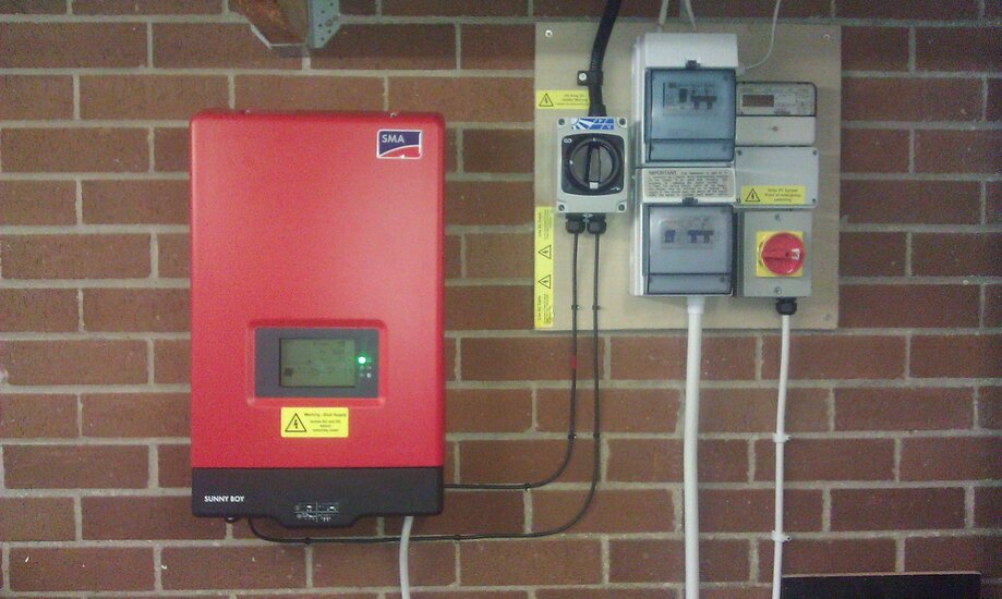

actually moggy, I reckon he might have got it right with the 2 garage units thing - one for solar, one for circuits in the barn, although I'm not really sure they've done it quite how we would have.
I'd have been expecting to see a reasonably hefty SWA cable somewhere though, unless the 6mm(?) t&e cable I can see is the incoming cable and it's been run through a metal pipe / conduit or something.

I think the swa is coming in from right of the DC isolator for the DC. I was wondering about the AC side, maybe, as you say, it goes into conduit of some kind. It looked to me, but may just be the way it looks, that there is a cable running from the garage unit to the consumer unit marked AC isolator. So the solar system is being run from the existing garage unit, wrongly sharing an RCD and pointlessly using 2 MCBs, migh be wrong of course. I had one like this recently but it was just to make it look smart, the cable was actually just passing through the first CU.
