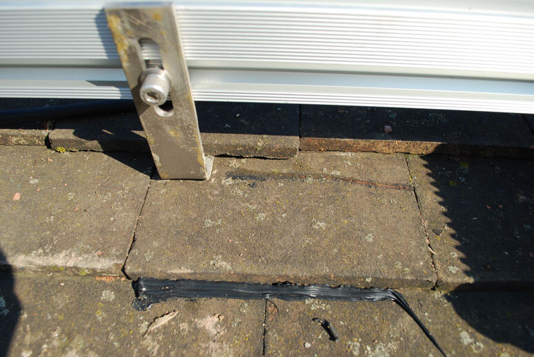

Currently got a half finished job over the weekend (due to freezing conditions which slowed work progress) so I've had the chance to take a look a the work so far- partly cause I have some other roofing work to complete whilst the scaffold is up. Please look at this photo and tell me if this normal or ok?
[ElectriciansForums.net] Is this considered OK, see photo.
I guess rosemary tiles are quite fragile and I'd guess the odd breakage is expected and around the brackets must be tricky - quite a few of the brackets are like in the picture. I guess if the work had been completed on schedule I might never have seen this, sometimes it's better that way! Appreciate your comments.
Cheers!
IMO, as a temporary fix OK until they come back, but this needs a new TILE ASAP as it cant be left like that unless you have cowboys !!
Certainly not acceptable in my opinion. Gobbing up a broken tile with a bit of bituminous mastic is unlikely to last 25 years. Replacement tile required. Perhaps more of a concern is that fact that it appears to have broken due to pressure on it from the hook. If that's the case, I would be concerned.
It's a common issue with rosemary tiles. As the bracket sits flush on top of the tile, there is always a slight bit of pressure as the array moves. Rosemary tiles, as you know, don't need a fat lot of pressure to break them in half.
To combat this problem, we use brackets which sit above the tile and use a couple of sheets of lead to maintain weatherproofing.
To answer your question, I would say repairing a tile as shown above is not a very good idea.
I do not think you need to ask really...
They should have replaced the tile, it is a pain when they break because you have to go and buy some the same, so you can spend half a day driving around.
Also the bracket looks very rusty for stainless, oh yes, and the cable has not been tied up yet and is rubbing on the tiles.

anyone doing rosemarys should know to bring 100 spare tiles and few rolls of lead!
there not SS hooks, look like cheap china, Caymax kit TBH.
On a roof like this if I couldn't get hold of my preferred bracket (which is wider and thinner so conforms to the tile), which is less prone to breaking tiles I would remove the tile underneith altogether and replace it with lead, leaving the bracket 'floating'. The risk is that even if they replace the tile it'll break again at some point in the future with the flexing of the bracket. The mastic won't help at all as the leak will be where the crack is. The mastic is just stopping the broken bit falling off.
If that is rust rather than mud on the bracket then the mounting kit doesn't meet the required standards, which are a legal requirement. If thats rust then in a few years time your panels will fall off the roof!!

HI, yes, k2, but the wide ones. I do still lead between the bracket and the tile and lap the lead over the lower edge of the tile, then if it breaks in the future the lead will hold it in place and maintain the waterproofing. It's not the cheapest way of doing things, but I like a quiet life. I don't want someone ringing me up in 2 years moaning that their tiles are falling off!
