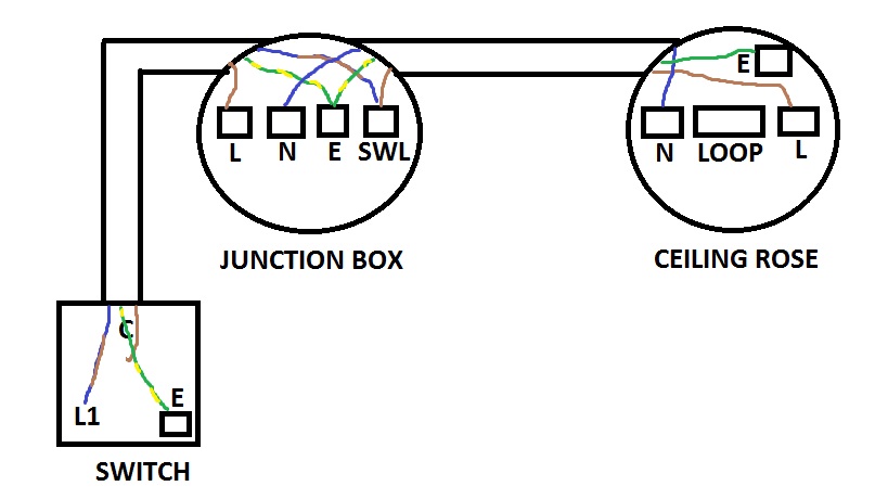

Hi again all, I started college a few weeks late so im a bit behind with the practical assessments
The tutor has said he will draw some diagrams with me next time im there to help me catch up
I thought id give it a go myself at home so just wondering if somebody can tell me if this is correct ?
The question was to draw up a one way lighting circuit using the junction box method
Thanks very much
Matt
  • [ElectriciansForums.net] Is this diagram correct
That looks as if it would work but I don't understand the need for a jb as the ceiling rose has a loop terminal for perm feed.

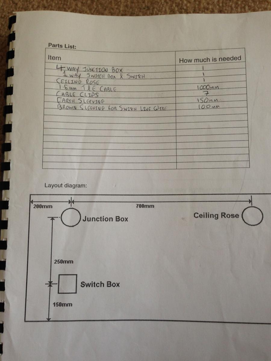

Thanks for the reply Sintra, to be honest I think thats whats throwing me a bit, here is the worksheet from college and the exercise :
Or should I be using a different type of ceiling rose if there is such a thing ? To be honest I went in the drawer at college and they all had the loop terminals so I presumed all ceiling roses were the same
Thanks again
Matt
I see what you are up against lol and what you have done is correct according to the information you where given.
All ceiling roses as far as I am aware have the loop connection and personally I wouldn't use a jb on the circuit. Again in my day it was referred to as a 3 plate wiring system but then again times change lol.
