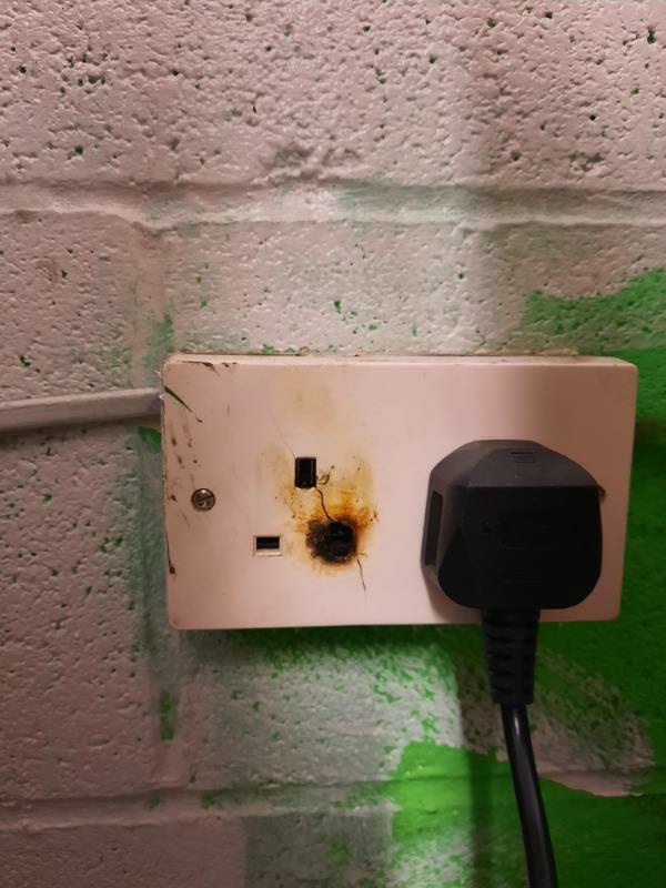

As title, call out to change a burnt out socket.
[ElectriciansForums.net] Its only ten minutes, burn out socket to change.
The why? was over use of fan heaters.

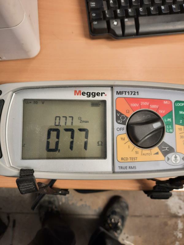

Quick Zs gave 1.26, something amiss.

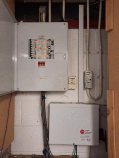

Did an Auto RCD test to locate source of circuit in this well labelled and populated board.

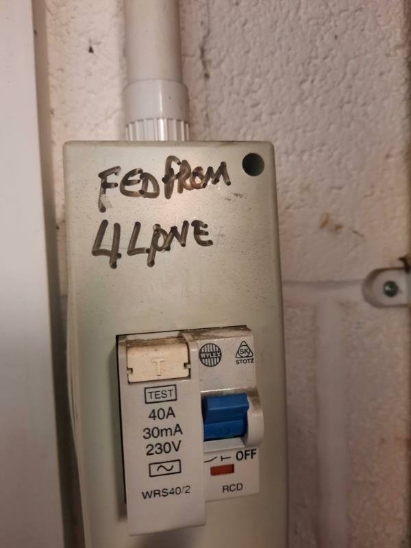

Found RCD to be a stand alone 61009

Now it starts to get interesting, took the cover off the RCD to find it fed in 10mm2 T&E and outgoing was the 2x2.5mm2 for the ring.
Well I say 2x as in reality there was one Neutral of one leg and one Line of the other leg as one of each had dropped out, the CPCs were sound in a chock block.
End to end gave an expected Zs of 0.66.
Managed to get it all terminated and...
Close enough...or is it?

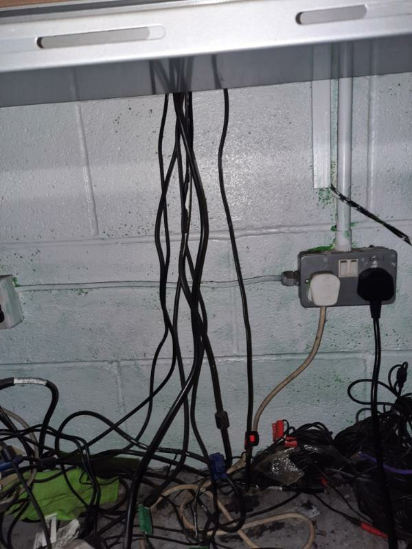

Had a scoot round under the desk and found..
The beginning of 5 double sockets spurred off the ring of which mine was number 4.
