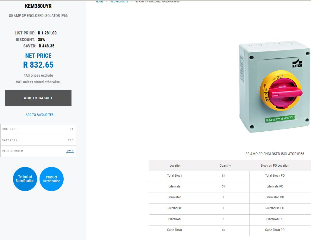

I'd probably go with a resin joint if aesthetics aren't a problem. Otherwise an enclosed isolator because they're cheap(ish). I'm lazy also and a ready made enclosed isolator is less work than sizing an adaptable box and fitting DIN rail and terminals etc.
