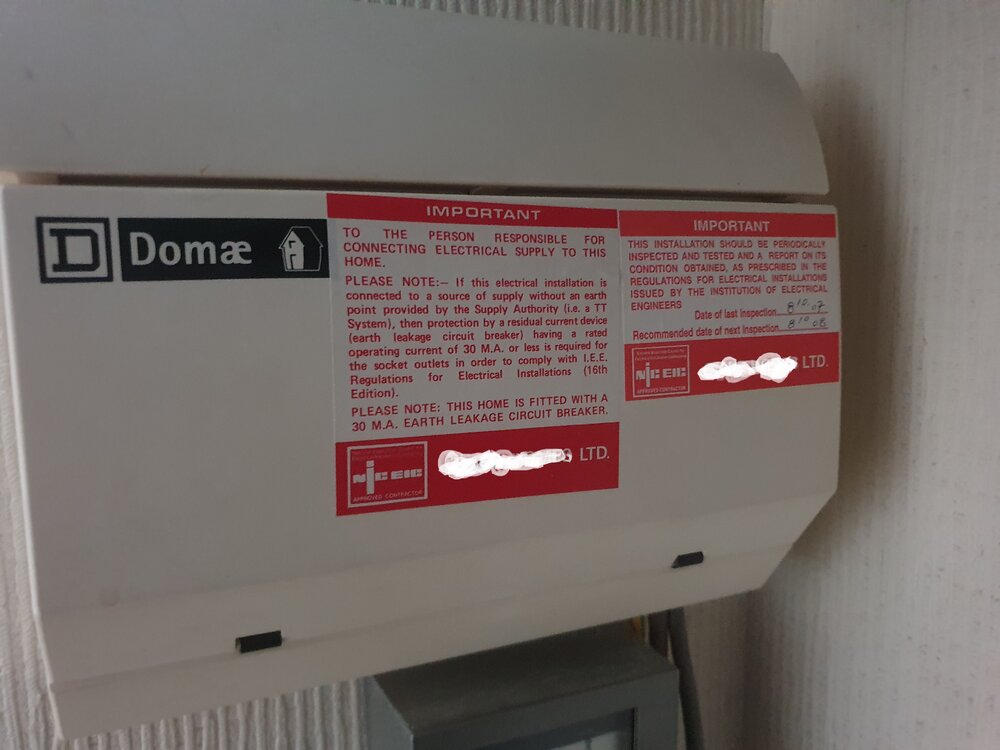

Seems to be my month for finding odd bodges by supposed professionals.
Installing an external socket in a shed today at a park home (non-mobile home) and find this label on the consumer unit:

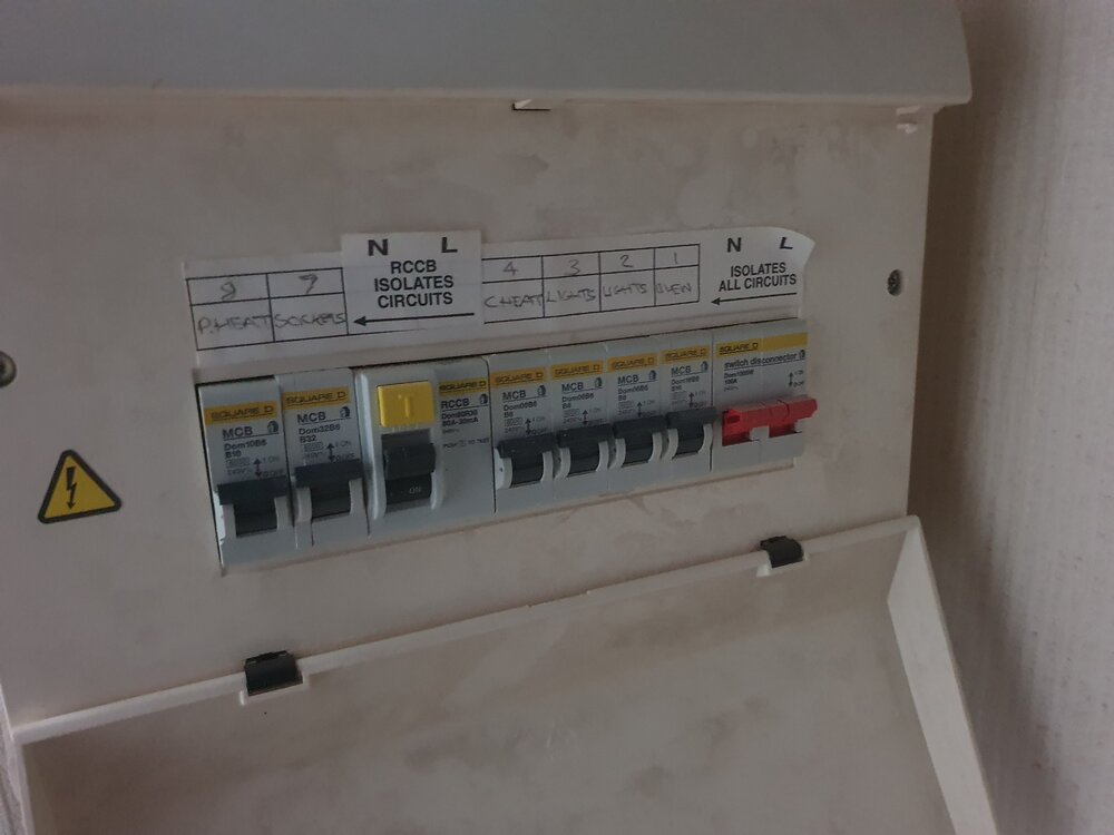

and this behind the door:
[ElectriciansForums.net] Joys of "Park" homes - Can an RCD be described as "Earth Leakage Circuit Breaker" ?
It looks like the CU was installed at the factory and then shipped with the house to site, where someone installed it on a TT and left it like it.
A more recent electrician apparently put a bigger earth rod in (8 feet rather than the 2 feet - Ze of 22 Ohm so fairly good as earth rods go) and the gas people discovered a 'reverse polarity' that was fixed.
But (according to the client at least) at no point did anyone tell him that none of the lighting, Central Heating or Oven circuits were protected by anything other than MCBs with a Zs that would certainly not meet any disconnection times.
The label is just plain confusing though. I know in the 16th there was a regulation that socket outlets needed RCD protection, and that's fine. But it ignores the fact that I've never seen a TT system where some sort of upfront RCD wasn't required for all other circuits to meet disconnection requirements. I'd have expected them to have fitted an S type RCD as the main switch at least, but no doubt this saved them some pennies.
I've also never seen a modern RCD described as an Earth Leakage Circuit Breaker - I thought that only applied to the old voltage ones which were considered obselete in the 80s.
Currently putting something in writing to the client so they can brandish it to the site owner, who is apparently not known for his adherence to regulations, and will quote for a new board.
Anyone seen a label like this before?
I'm thinking I'll quote for a Fusebox RCBO board with SPD as they seem good at the price. Though even a Screwfix special dual RCD would be an improvement!
With Zs of 22 ohm it would possibly not disconnect on a 6A MCB, even if it did it could take an hour! While the regulations don't demand a RCD in the TT case, it is practically impossible to meet the disconnection times (if at all) without one, as you say.
It is possible that for a while the RCD approach to measuring leakage was generally referred to as "ELCB" as that was the job it was doing, though it does not operate in the same manner as the old VOELCB devices.
In the 14th edition they had ELCBs which could be voltage operated or current operated.
The current operated ones were the same as RCDs the voltage operated ones tripped when the earth conductors of the installation were more than 50V above earth.
Ah, that might explain the notice mentioning a 30mA ELCB, which is not relevant to the voltage operated ones. Perhaps they just never updated the label (other then changing to 16th edition)
It's quite possible that the instructions for 'installing' the house originally said that it must be connected via an RCD and the site owner didn't bother. The feed to this house is currently on a 60A Wylex switched Fuse in the meter cupboard between pitches. If that had been installed as a Time Delayed RCD then I guess it would have complied under 16th.
I haven't done any calculations yet, but there appears to be no earth in the meter cupboard for the submain either, so the Wylex fuse is likely only providing L-N fault protection for the submain. The cable coming into the home I think is armoured, though naturally not terminated correctly. The meters are all supplied by the Site Owner himself (He buys it in and resells it apparently), so none of it is the DNO's responsiblity.
It may turn out to be a can of worms, but I'm interested in any one who has worked on well installed Park Homes to confirm what best practise is?
The current situation is:
Site owners cupboard: Wylex 60A Fuse (BS5419 isolator) -->
16mm SWA (I think) - about 15 meters to the home (Not terminated correctly in the home, although that may have been to ensure no earth was exported to it - even though I'm not sure there is one at the source of it anyway..) --->
Customer's board - RCD on sockets and "P.Heating" (unclear what that refers to as there is C heating on a separate feed) but no RCD on 2 lighting circuits, C heating or Oven
I'll be quoting for a new RCBO board for the home itself, probably with SPD. Or a dual RCD board at worst if price is a major factor.
I'd also think that the sub main isolation switch should be changed to a suitable RCD (S type or perhaps 100ma?) to ensure safety of the sub main (with suitable discrimination) so will be pointing out in writing to the customer that the site owner should be doing that or providing certification to show that their installation is acceptable.
Check the Zs at the end of the sub-main, if it is low enough to meet 5s disconnection with that fuse it is fine.
That assumes it is properly glanded at the source end, of course! Otherwise a fault might just start a fire there.
If the supply Ze is too high for that to be practical then having a delay RCD feeding the sub-main is the obvious solution as you suggest. But that is still not an excuse for the sub-main armour not being soundly connected to whatever system earth is present (TN or TT).
I thought the disconnection time for a TT installation was 1 second? Not sure if it's always been that or if it was 5 seconds in previous editions? Or is that assuming a supplier earth at the switch fuse?
The cable was 2 core 16mm and the armour was just taped up at the customer end - I didn't get into testing because of time, but will definitely investigate if/when I go back.
It's possible there is some sort of supplier earthing in that meter box that wasn't immediately visible - There was no obvious earth to the switched fuse, but the SWA wasn't terminated into it either, so there may have been a good termination with a suitable earth that was hidden. If I go back I'll test to confirm.
