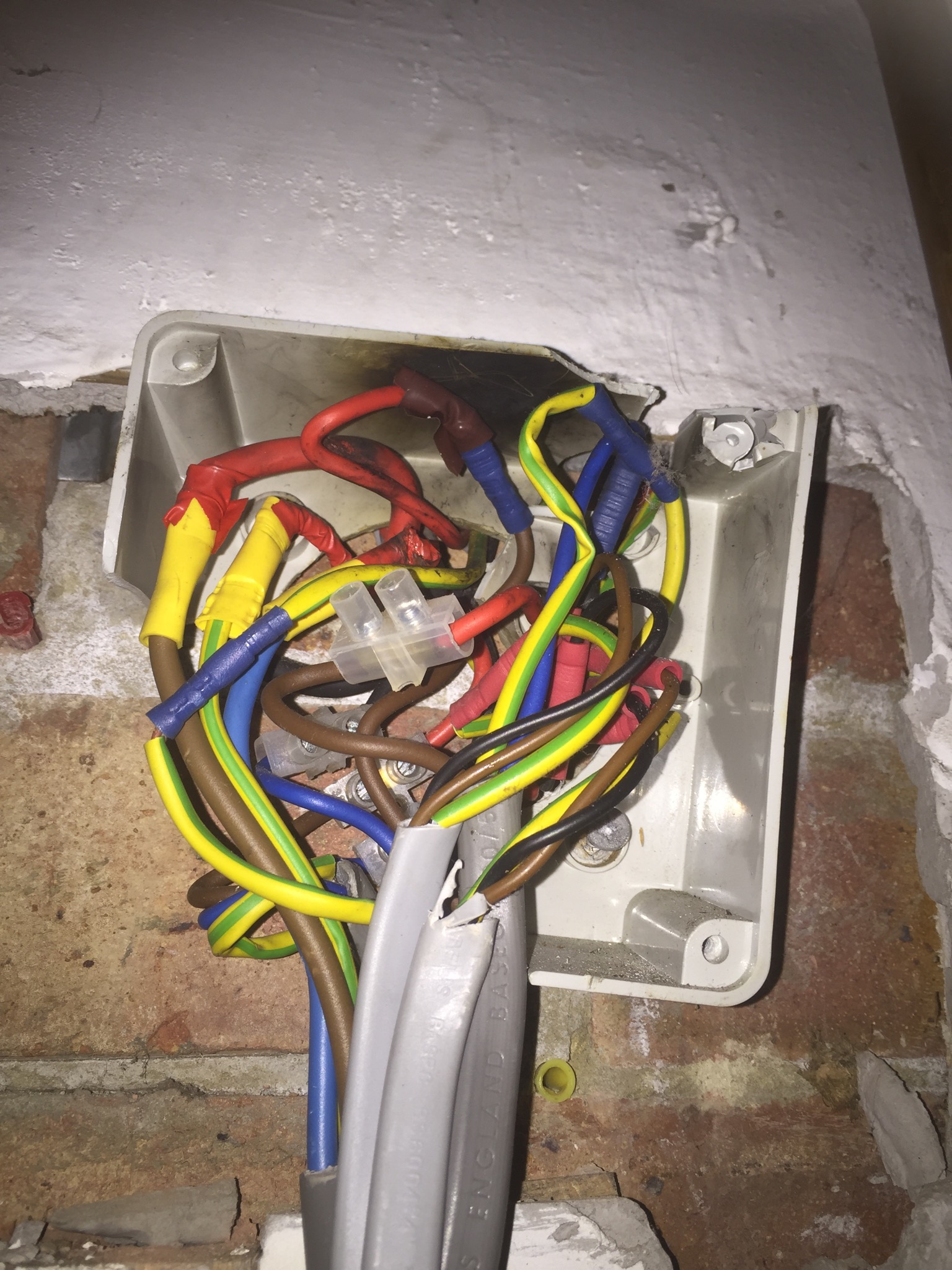

I went to look at a job the other day for a customer to install a Hot Tub supply in the garden. Whilst there I found that an 'electrician' in the past had extended all the cables down from where an old wired fuse board used to be located to an RCD protected CU.
It was basically a bodge where they had crimped and terminal blocked all the existing T&E, to new and tried to ram it all inside a JB to make it look pretty but over time the JB had split in two and when I took the cover off I found an unsafe mess with obvious signs of damage between conductors that looked like someone had decided that a bit of insulating tape would resolve the problem!
I said to the customer the first priority before I do anything is to sort out that mess, which he has no problem with. I also pointed out that I would need to test each circuit to make sure they were all ok.
You can see the brickwork where the old fuse board used to be. Above the white is plasterboard that goes up about a foot before it disappears into the floor void above and all the T&E is run in galvanised steel attached to the brickwork. I can remove that plasterboard and free up some slack to allow me to terminate it okay.
My question is I am looking at terminating in a JB using din rail mounted Legrand Viking 3 terminal blocks, I can't remember the exact number of circuits it's written down in my note book in the van but I think it was 3 x 2.5, 2 x 1.5 and 1 x 6. If I go down this route does the JB need to be metal to conform with AMD3? It's probably in the grey area!!!!
Or does anyone have any better suggestions to extend the circuits down safely?

And considerably better than the pictured mess!

I would use a metal enclosure, no comebacks then.

As I say there is no possible argument as to how 421.1.201 could apply - a junction box can in no way be construed to be a similar switchgear assembly to a type-tested distribution board - indeed it isn't even a switchgear assembly!
But you are certainly welcome to use a steel box if you want. However in no way could it be argued that there is any requirement if plastic was suitable for the environment etc.

Ooh that enclosure looks perfect. Thanks for posting that. The wording of 421.1.201 clearly says Consumer Units and similar switchgear, as there is no switchgear in what I am doing, then I will interpret it that a plastic enclosure is ok. As others have said, anything to tidy up that mess has got to be safer.
The CU itself is probably about 2 meters away in another cupboard, so the joint box enclosure is not going to get damaged if the CU decides to self combust, unless the whole house burns down!!!!!!
