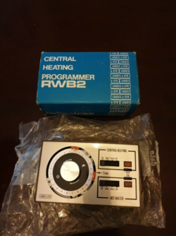

HELP !!! i need to replace the above. priced at ÂŁ225.00, client not happy. what i would like from esteemed experts in heating field is ... what can i replace with at sensible cost. connection wise, there is only L and N in and a T/E back to wiring centre in 3 and 4.

If it's old enough to have one of those fitted it's probably Gravity hot water (it'll have the peg twisted on the back so it's Heat and Water or Water only (not Heat only)
3 will be power to the boiler, 4 to the heating pump. Down the T&E with L internally linked to the switches from the supply in.
There's loads of plain 2 channel electronic programmers, but if you want a mechanical one Siemens do this one; (does Gravity Water) Vat not included on that price.
cheers for that. also found a digital version the RWB29Si that suppliers list as being a direct replacement, even fits on existing backplate. ÂŁ50 + post.
