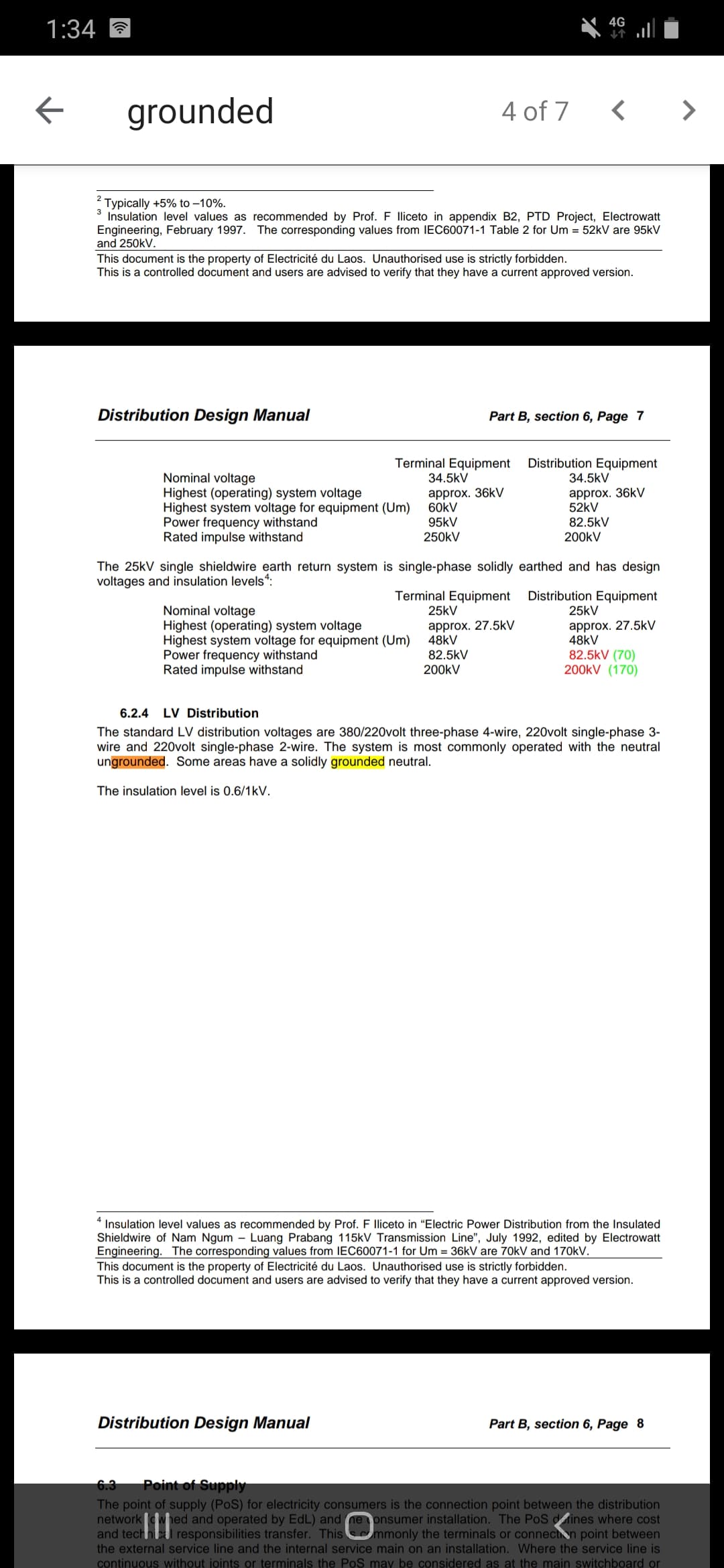

EDIT: OK just read a PDF of the Lao electric power technical standards... most LV distribution has the neutral not grounded... this just keeps getting better... you can't make this stuff up. :rolleyes:

Just incase anyone thought I'm having a laugh (I wouldn't blame you lol) I've attached a screeshot of the PDF...

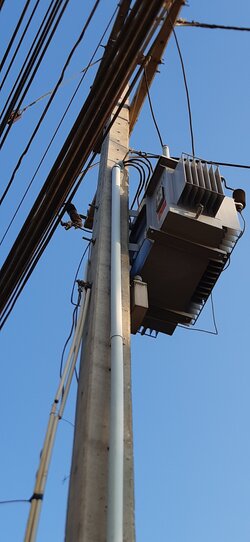

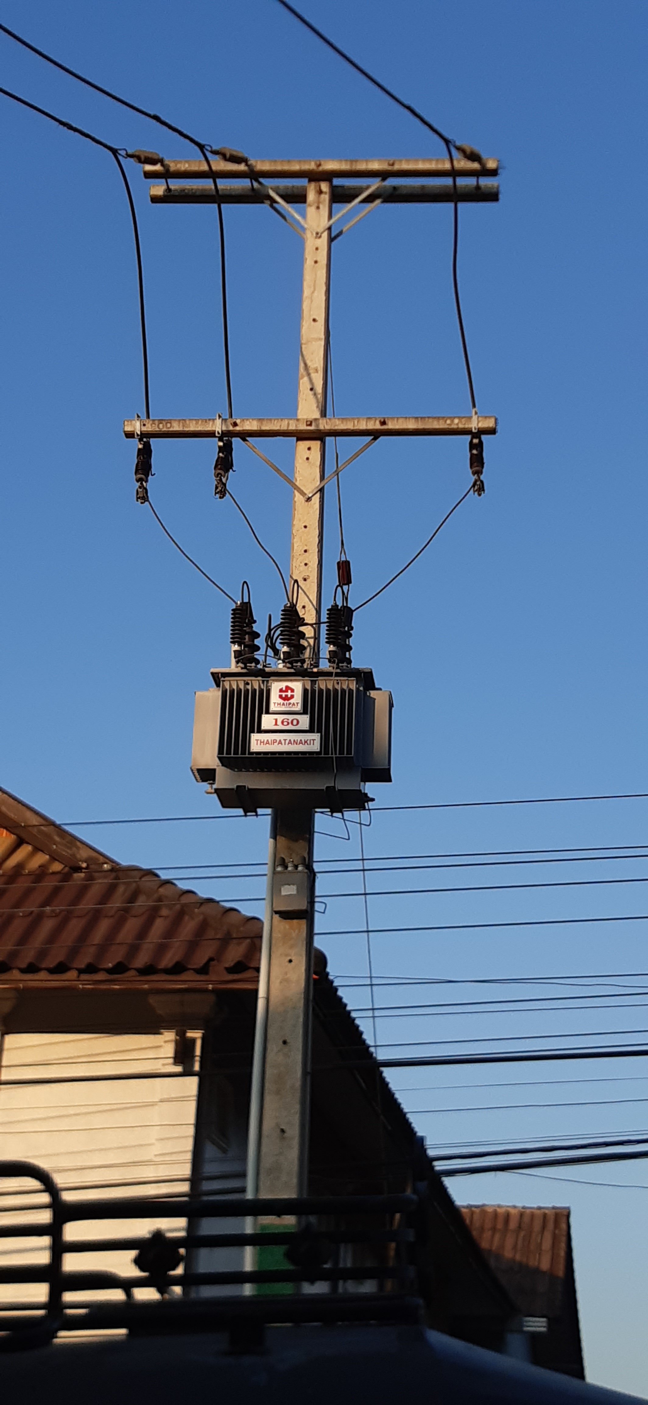

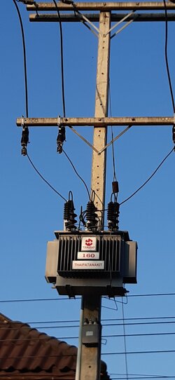

I agree with Robson689, get some local advise. It looks like you have a 25kV earth return system ie one overhead line conductor which feeds one HV terminal of the transformer the other terminal is connected to a spike so normal load current flows through earth. This will give strange voltages in the ground. The LV side looks like it is an IT system. Neither of these systems are allowed to be used for public distribution in the UK.
Thanks mate, so if this is the case as you described... I'll just put everything back the way it was. I think I'm just making things worse potentially. Back to cold showers... it's actually kinda nice haha.
So on the primary side of the pole top transformer (facing the power station i guess?) there is actually current flowing through the actual soil back to the powerstation? How does that work? That return path resistance to the power station must be in the petaohms or something... o/c basically. But im probably missing something again :)

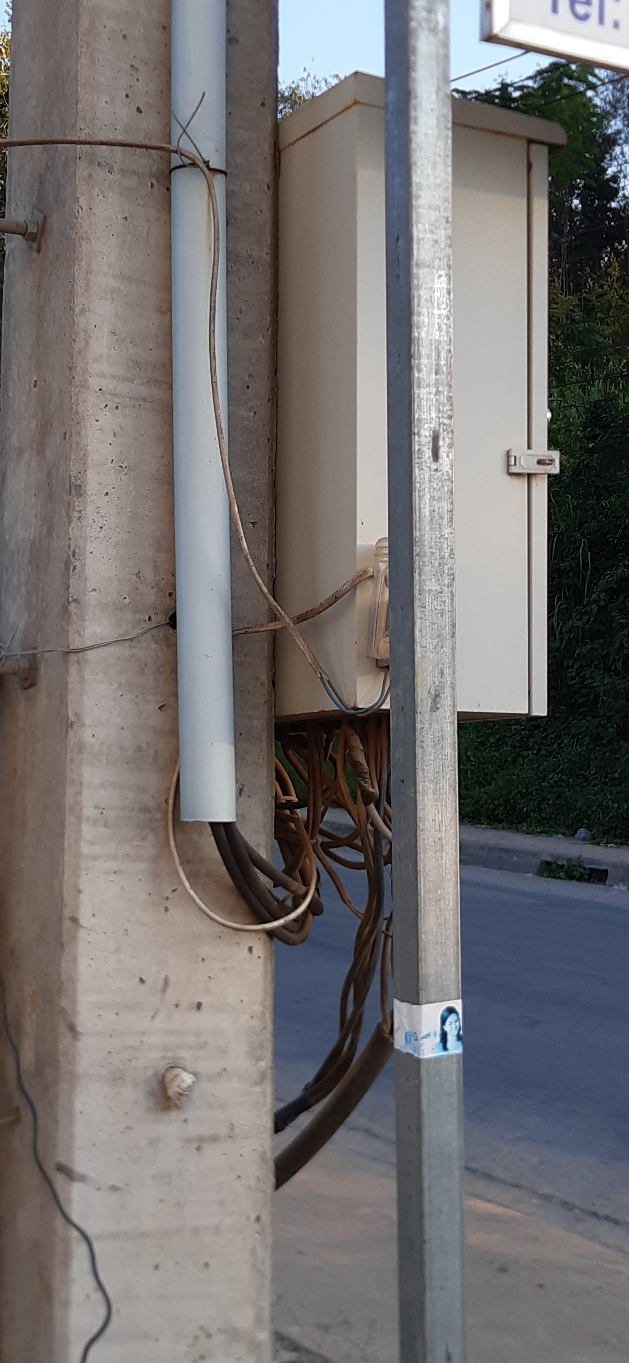

I cant be 100% sure, but based on some dodgy translating and hand gestures, the local "electrician" who fitted the earth to the water heater yesterday seemed to say that the whole house was "grounded", because there was a cable going from the brick wall into a ground rod and that everything was ok.

It's actually pretty low. The Ra of an earth rod is mostly associated with the soil around the rod. Although soil isn't a great conductor, the cross section of the useful path to the substation over much of its distance may be measurable in square kilometres instead of square millimetres. So if both ends are equipped with a good mat, it can be in the same order as a metallic return conductor but it costs nothing. Earth return is used in sparsely populated places where it's hard to recover the cost of the line plant. Last time I saw it was in Iceland.
