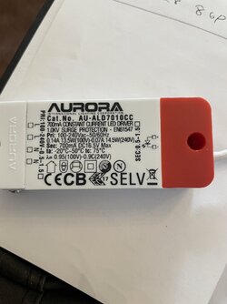

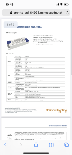

Hi
Looking for a bit of advice on a led driver
The Aurora in the picture below is the one that needs replacing today / tmrw
And the only 700ma constant current driver I can find local has slightly different specs DC 16.5v max on the original
33 - 40v dc out on the new one
Will this work ?

My opinion is no, it will not work. The proposed replacement part has far too high a terminal voltage compared to the Aurora part.
