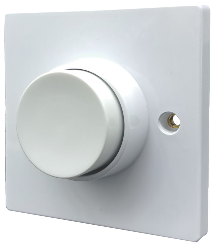

Would something like this be easier?

I was thinking this, but it would only work when they leave work, at the switch would be in the building.

No the flood lights are fed from the upper floor so would need to get a cable down to the lower floor entrance which would be a right pain.. Plus the lights are fed from two different consumer units, two different circuits, about 30m or so apart so would be a lot of cable to run, hence the wireless option is definitely much cheaper... Sometimes they leave at say 2pm and come back and open up at say 6pm, so because the use is all over the place any sort of time is just out of the question..
