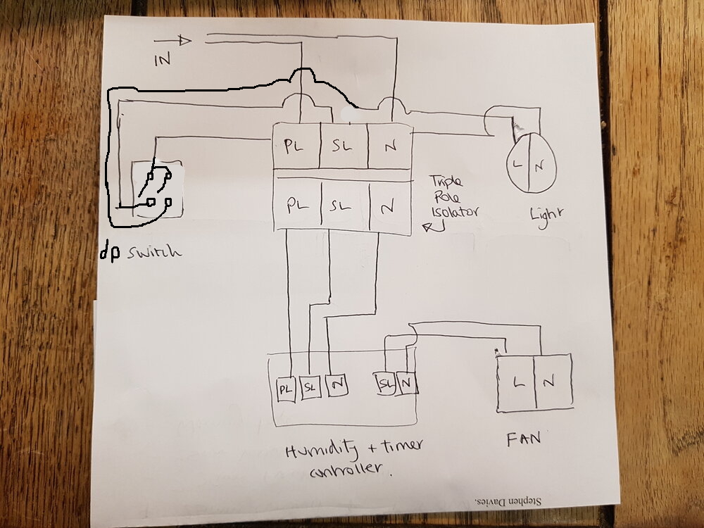

I have just fitted the manrose humidity/timer remote unit into a bathroom (see pic below)
[ElectriciansForums.net] LED light in bathroom flashes when extractor fan TP pole switch is closed.
When I switch the LED bathroom light off, it starts flashing. If I switch the TP switch for the extractor fan off it stops flashing. This only started happening when I introduced the humidity/timer remote unit.
I could understand if the LED light stayed on dimly, but why is it flashing? My idea was to fit a 230V snubber across L-N of the light, would this work? Is there a particular rated snubber that I need?
Could I just fit 2 x 160Kohm 1/4w (230V) resistors across L-N at the lamp?
Would these be suitable:

seems likely it's the fan controller causing the problem. snubber would be your first shot. maybe a comined R/C snubber.
Do you fit them as shown in my diagram Tel? I.e across line and neutral at the lamp? Any particular snubber you use?
Depending how the circuit is wired you could use a d/pole light switch and switch both the live and the neutral.
Other than cheap low-wattage ones that use a capacitive dropper, LED lamps have a switched-mode power supply as a driver. When stray capacitance in the wiring or a control device like your humidistat leaks a small current into the switched line, it passes through the rectifier and slowly charges up the reservoir capacitor in the driver until the voltage is high enough for the circuit to start up. It delivers a brief pulse of output to the LEDs, but in a few milliseconds the charge stored in the capacitor is used up and it shuts down. The capacitor begins to charge again...

I suppose if the N was brought to the last terminal instead of the earth, that would equalise any potential across the lamp when switched off? Not sure it's a good idea/compliant though, something to do with switching neutrals
Using a change-over switch to short out the lamp is perfectly OK as you are not switching the neutral, you are switching the live feed to the lamp (i.e. at no point would both lamp terminals be live due to an open on the neutral path).
But...I would worry about the next one changing the switch getting a nasty surprise as it is so common/normal to have unsleeved blue (or black) as the switched live to a light (not really neutral)!
