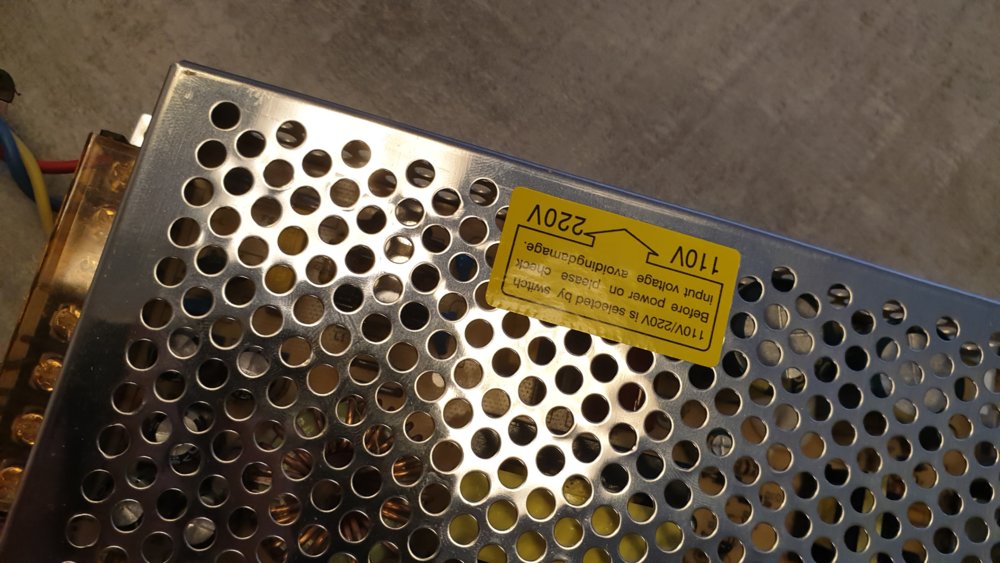

What incorrect wiring issue would cause this to happen? I wired a mains plug to the PSU (positive, neutral and earth) then measured the output of the PSU. I also have the switch set to 220v input rather than 110, altho the input is actually 240v as its UK mains power.

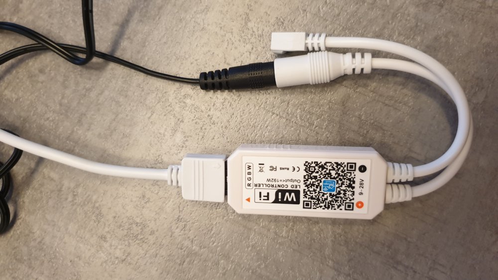

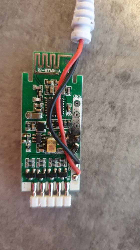

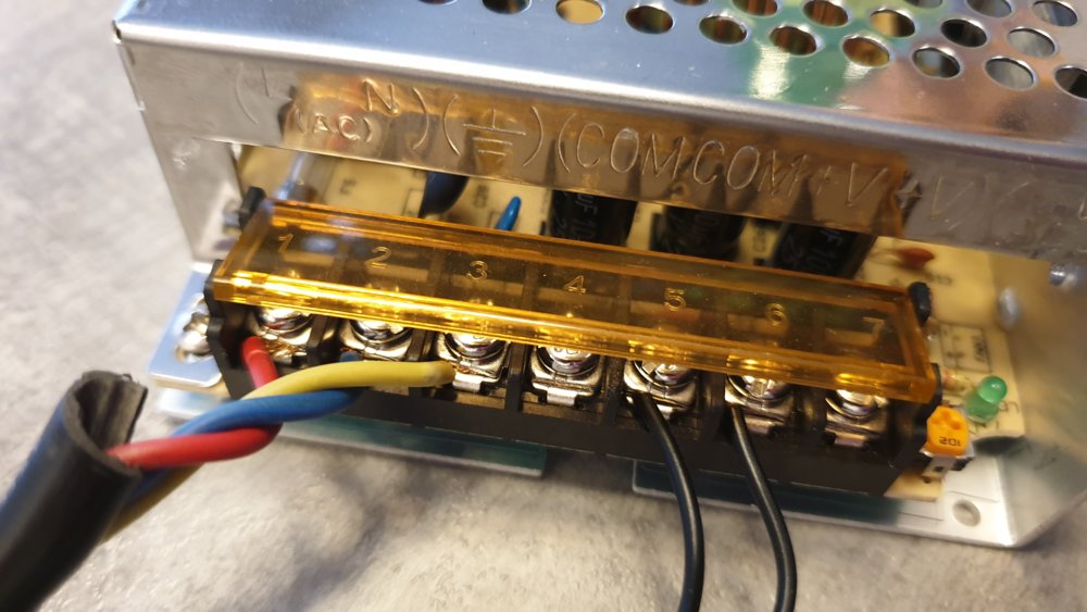

Here are some photos guys, any help appreciated

In your OP, you say that when you measure the current there are sparks and the wires get hot. Have you connected your meter to the positive and negative outputs of the power supply?
Can you unplug the black Jack connector ,from LED unit
and do a Picture of Innards of white lead you connect it to. (If possible to see !)
(strange how cables are marked "Plus and Minus")

... If cabling is getting warm -sounds like a Short circuit....
(May be damage from getting polarity of DC output wrong )
+1 for checking the polarity. The white stripe on the black cable would usually be +, from your photo it looks like the striped wire is in the - terminal.
Hmmm... Does the multimeter not read negative if polarity is not correct? I've had the striped wire in + during all testing also
Yes, is this not correct?
