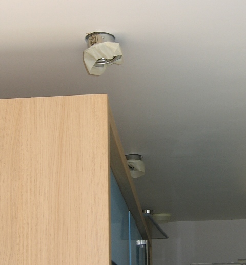

Hi, I'm wanting to have some downlights fitted with gu10 LED bulbs 4w equivalent to 50w. The ceiling measures 5.92m by 3.57m. Can anyone advise how many would be suitable for this room size and how best to space them. Thanks
What room is? Because if its the kitchen the cupboard will throw out all of those calculations. Its not good having a down light directly above a cupboard. And then there's the joist spacing etc, I hate spacing down lights, actually, I hate down lights!

Yipee458 selecting a dimmer switch is dependent on the lamps you have the lamps must be suitable for dimming and will normally specify if you need a leading edge or trailing edge dimmer. Whichever type you need they must be low load dimmers capable of running at a low wattage normally 0-100W or so.
Standard dimmer switches may work for a while but will eventually damage the lamps as the output is not suitable for LEDs.
BTW a 4W LED lamp will only be likely equivalent to 35W. Keep an eye on the beam angle as well.
