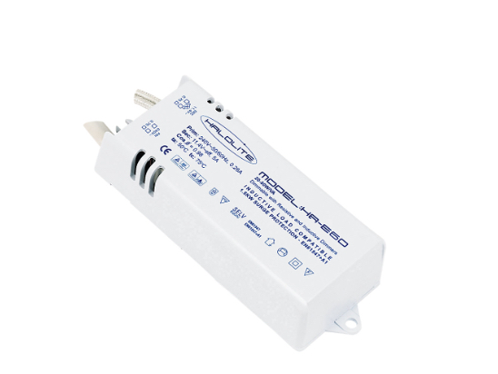

I am replacing 3 lighting transformers in my kitchen.
The existing ones plug into 3 x main sockets which are on the AC mains circuit via a light switch and are earthed.
The replacement transformers have no earth connection - do I need to earth the new transformers? If so, how?
It's a DIY project, any pointers appreciated.

Does the new transformer have a logo, a square within a square? if yes then it's double insulated and doesn't require a cpc.

plenty electricians in manc area could wire this up properly 4u. lights fed from 3 13A plugs via light switches is so Romanian.
Hum ..... lighting transformers in 13A sockets ..... op could you post a picky of the new transformer ?
And why not a like for like replacement?
