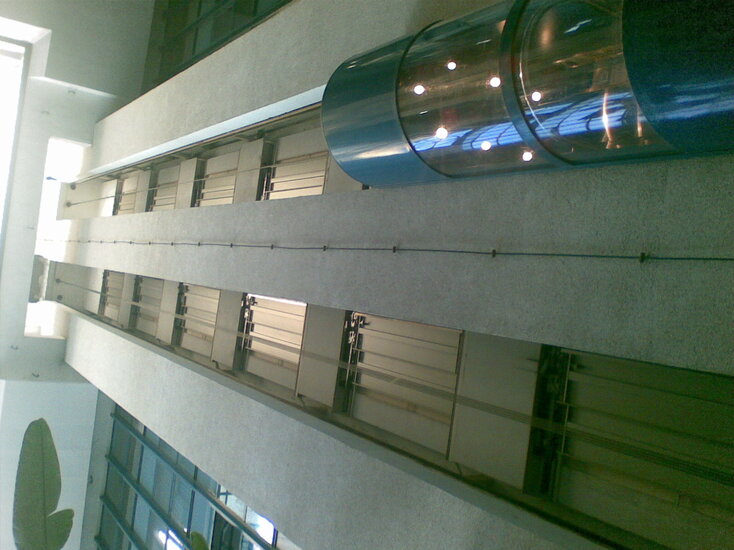

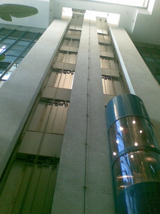

Engineer 54,
Attached is a photo of the lightning conductor we have been talking about. As they say. 'a picture is worth a thousand words'. The question is: is the down conductor within the lift shaft?
[ElectriciansForums.net] Lightning Protection
  • [ElectriciansForums.net] Lightning Protection
Becomes much clearer now Gibeltariq, not an actual lift shaft but still on the building fabric associated with the lifts, and in quite close proximity to the 2 working public lifts.
Personally, i think the proximity to these 2 lifts is just too close for comfort, and the steelwork associated with them could well provide a better path to earth than your down conductor, from what you have posted before. In fact i don't think i've ever seen a lightning down conductor routed through an interior public area let alone so close to lift equipment. Is that down conductor 50mm2 hard drawn copper, or normal soft copper??
I wouldn't be happy with this installation Gibeltariq, you can try and get another opinion, but i'm pretty sure your not going to find anyone that knows about lightning Protection, that would be too happy about this down conductor routing either...
