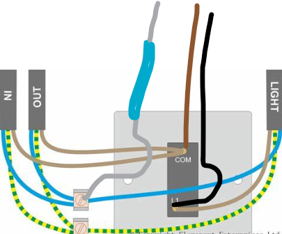

Scenario 2 - Loop in and loop out at the switch with N and PL at the switch:
[ElectriciansForums.net] Loop into Fan
In both cases:
Grey is sleeved blue, and takes N to the fan via isolator (see below)
Brown takes PL to the fan via isolator.
Black takes switched live to the fan via isolator.
The 3 pole isolator simply interrupts all of them to allow maintenance of the fan..
CPC omitted from diagrams
Does that help?

It’s more when taking from the switch PL still stays in the common? Let’s say converting a normal bathroom light. Which has PL in common neutrals in block. SL in L1.
Do these cables stay where they are, before introducing the 3 core. I get the isolator part that’s find

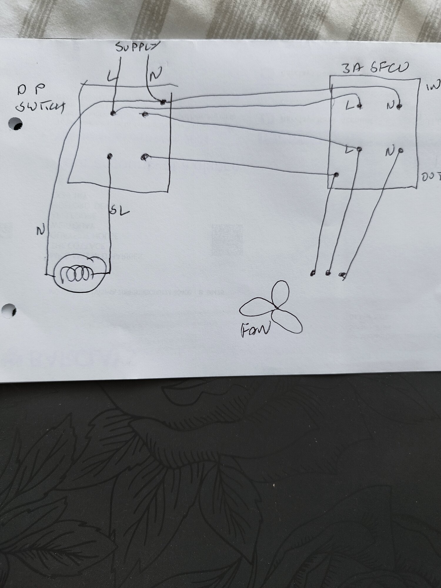

I have posted this years ago, it is the way I wire fans which gives the fusing required by a lot of manufacturers and the isolation required allowing the light to operate when the fan is isolated, a lot more convenient at night if you only want the light on.
Really only for new work or very straightfoward to do if there is an easy route from switch to existing isolator. It looks busy but the only difference between this and what is usually done is that instead of running a 3c from switch to isolator you run 2 x 2c, one is taking the supply l & N, the other is a switch wire for the now fused L to and from the switch
