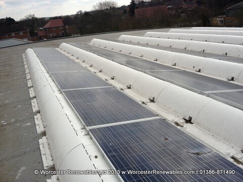

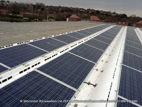

I need a ballasted flat roof mounting where the highest part is around 300mm from the flat roof. Looked at Tric F box but that finishes about 430mm.
Can anyone recommend me one?
Thanks Matt
K2 (krannich) they have a 10 degree one - K2 S-Dome
Solion Sunmount (260mm) just measured it :)
[ElectriciansForums.net] Low flat roof mount needed please.[ElectriciansForums.net] Low flat roof mount needed please.[ElectriciansForums.net] Low flat roof mount needed please.
Or maybe Schletter Alulight or a variation of their FixZ-7 using their solcube ballast system
