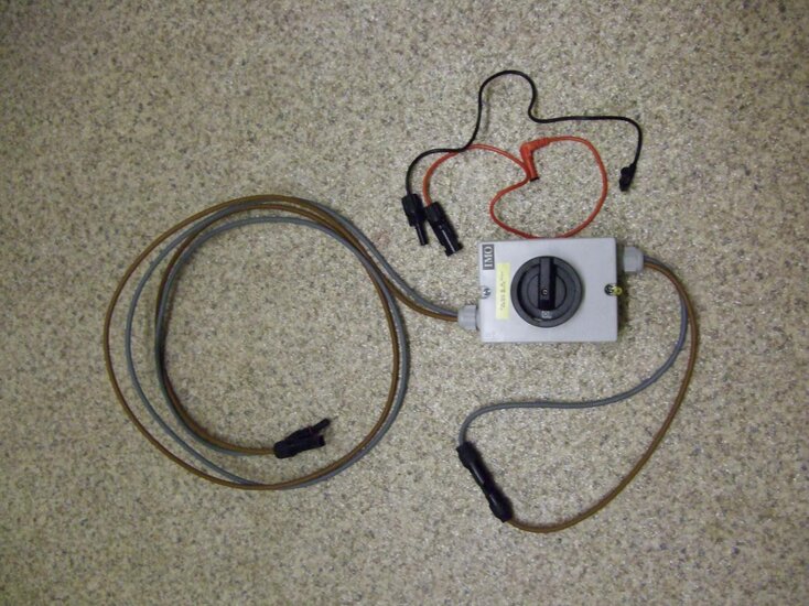

Our crews use a simple test box with a DC isolator and probe leads with MC4's on so we can do Voc and Isc quickly on every panel before it goes on the roof, as well as once strung : [ElectriciansForums.net] low generation

I initially thought they were mc3's but i got some mc3's from the wholesaler to make the leads up with those and they were far smaller than what we had on the panels. Think i might have to make myself up one of those!
