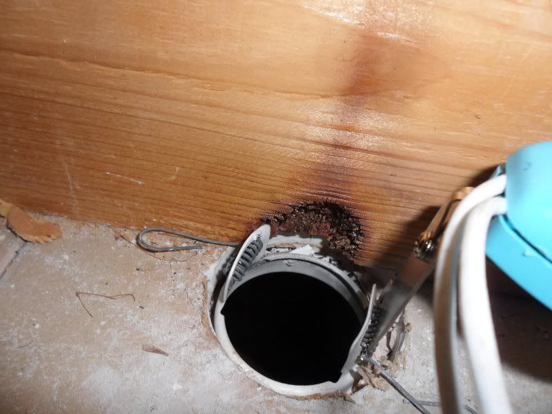

Halogens only really cause fires when debris (Dust, hair, wood chips etc) in the dead space fall on a bare lamp which as discussed gets very hot.

Here's the result of one I found:
