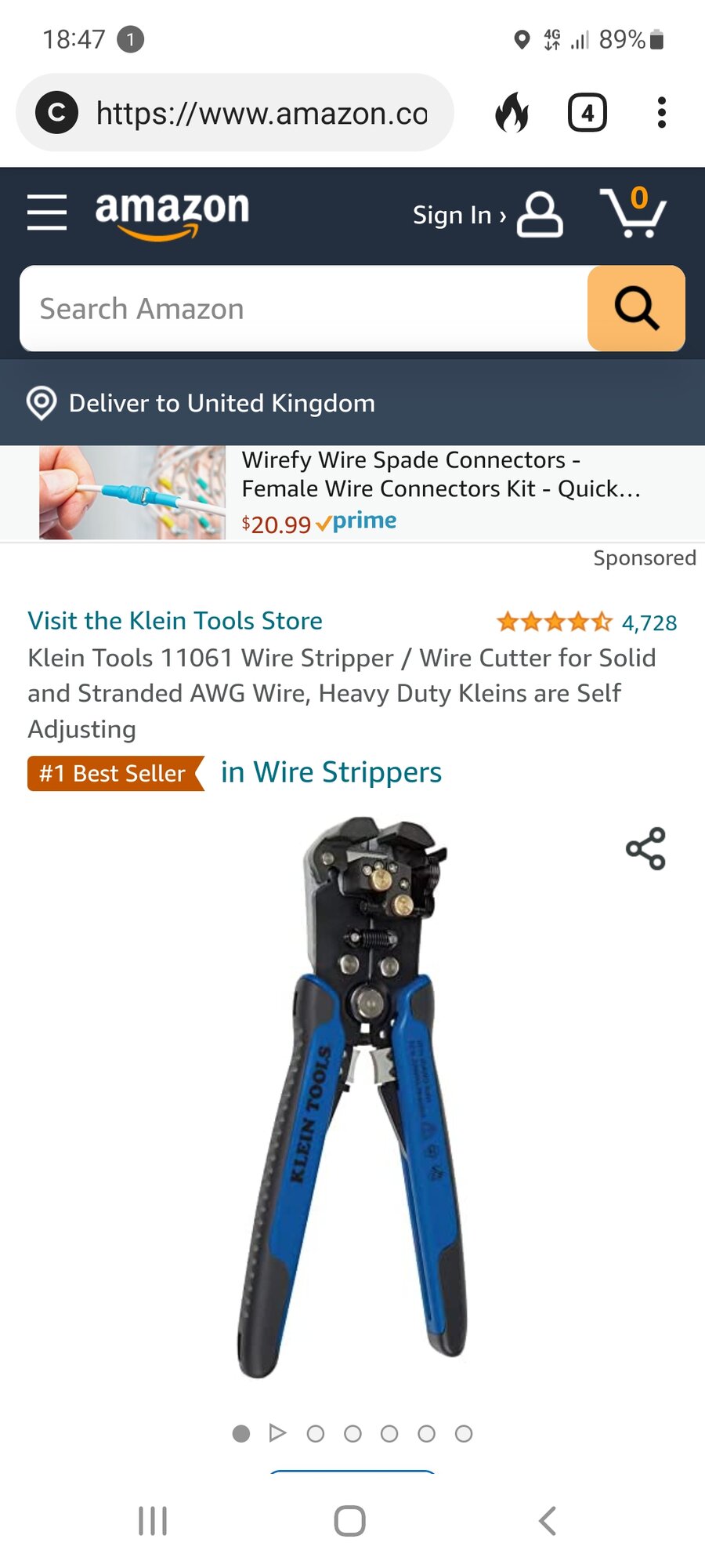

Not with these...
If I get a year out of a pair I'm happy, treat em as a consumable but they are worth their weight in gold.
Yes, it take a fair tug to pull it off but it does come eventually.
Also leaves a nice neat end which helps to keep the cable under neat.
Given patience you just strip a bit and pull it off, then repeat until enough.
I have the CK equivalent and find it great for T&E as it gives a neat finish on the sheath and you can use it on the conductors. However, the cable cutter/crimp bits between the handles are a pain as they sometime nip your palms, so I took an angle grinder to my ones to take the worst of the bits off. Utterly useless are crimping the R/B/Y style of insulated terminals anyway.

Not with these...
got the identical one myself. Klein. still a pain with lsf. I do 2" at a time. also use a knife at times. (shh .H&E may be watching).
