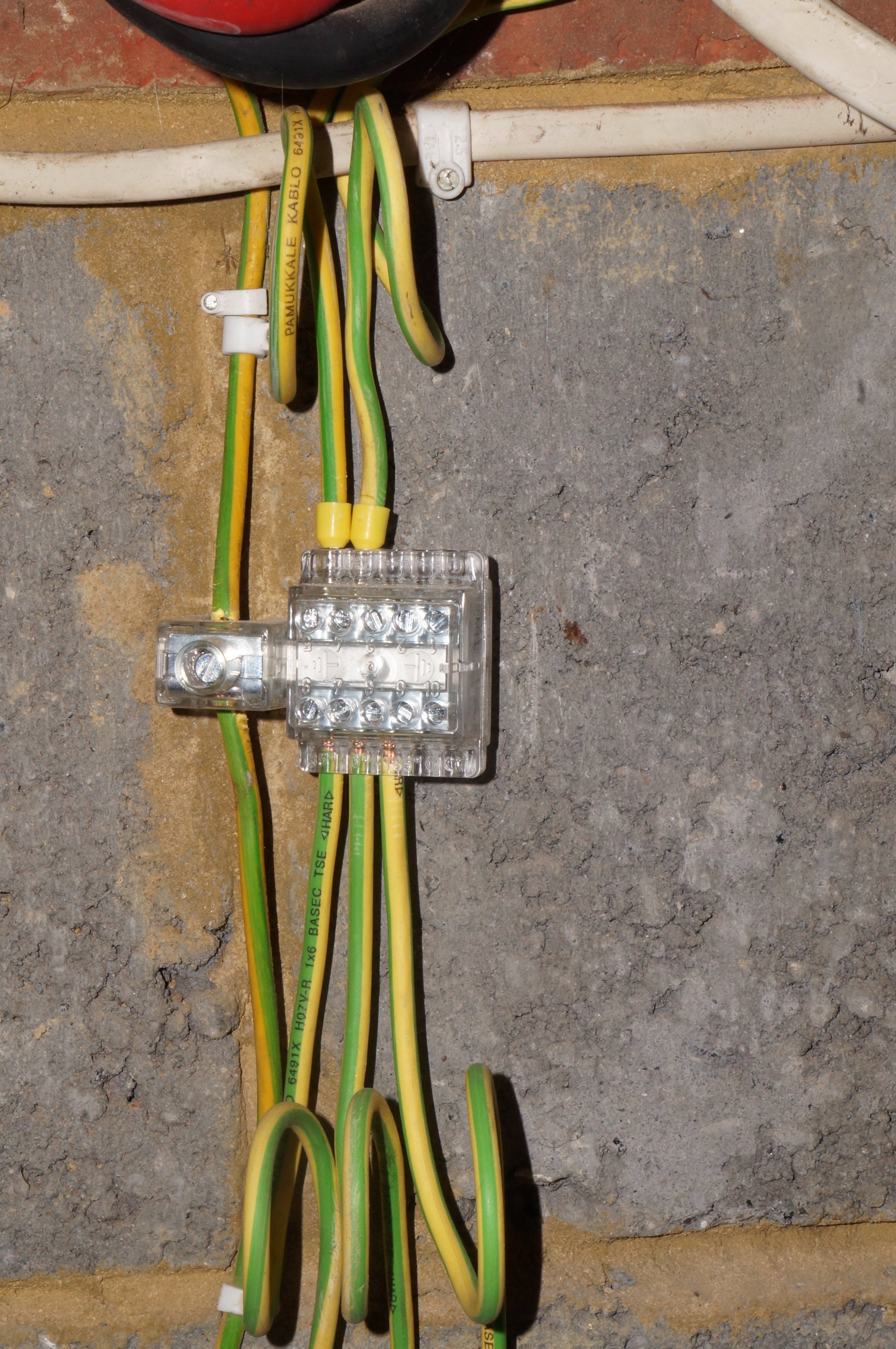

One of these between the earth rod and gas main would allow disconnection from the CU and gas pipe: barrette de mesure terre - Recherche Google - https://www.google.com/search?
[ElectriciansForums.net] Main Earth and Gas Bond
Is having to disconnect inside the DB an accessible position?
Surely it's easy enough to just drop the wire off the clamp on the gas pipe during testing ?
Indeed it would be. But that would mean having 2 things to disconnect instead of one. More margin for error. Of course, any diligent spark would pick up on this and just do what you said, but it seems against the intent of the reg quoted to have 2 things to disconnect.
