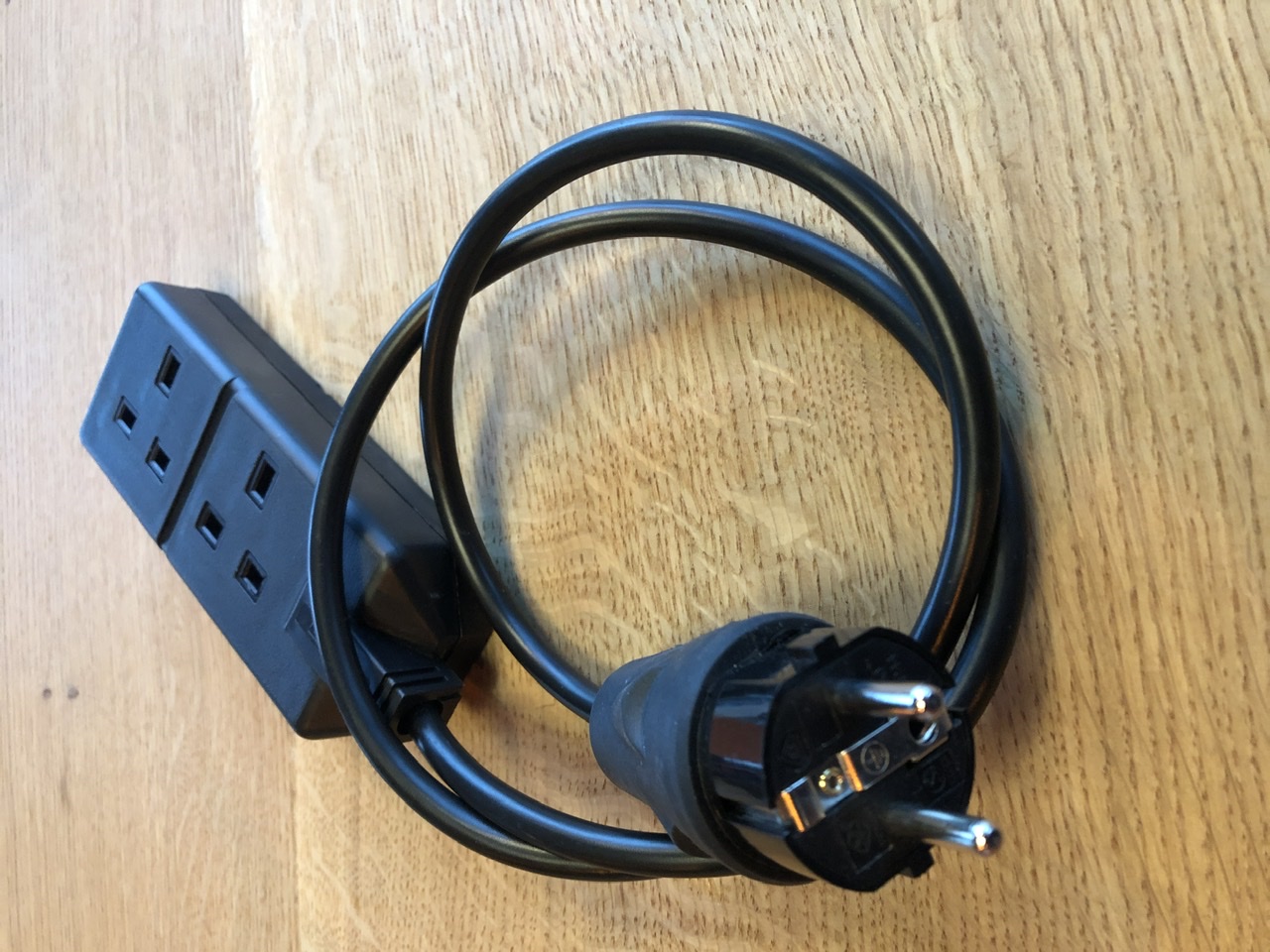

I've a large rental stock of properly made up mains adaptors for use in Europe and elsewhere - so typically something like a Schuko >1m 3c H05 / H07 1.5mm flex > twin 13A duraplug trailing socket, variants for other countries, USA and so on.

However..... All the above outlets rely on protection in the circuit, not a fuse in the plug. Because of the built-in USB chargers in this unit, should this still have a 13A fuse in circuit??? Interested to hear people's take on this. Also.... BS7671 doesn't really apply here (even though of course we continue good advice and best practice) because of being used overseas.

It needs a fuse as it could be plugged in a 32 amp ring final.
To clarify - the source of supply will typically be a 16A or 20A radial in most settings, Schuko plugs are rated at 16A.
I would have thought the built in USB charger would be ok without protection from a 13A fuse. The ones built into socket outlets rely on the circuit protection, which could be 32A.
Comparing time/current curves,a 16A MCB offers similar protection to a 13A fuse anyway.
Charger wise, of course, without 1362 fuse is the norm....phones, power tools, etc....unless you have a fork lift truck 😉......or a car, maybe.
Can't see any problem with 16amp protection at circuit source.
A 13A BS1362 fuse won't protect a small 5V SMPSU in any meaningful way. If the USB supply module is made to a decent standard, it will have a fusible resistor or SMD fuse or similar on the board, appropriate for the fraction of an amp that the circuit needs. If it doesn't, and any of the usual faults occur that more or less short the mains input, it will go bang with or without the 13A fuse. A C20 upstream might lead to a bigger bang.
OTOH the multiple mains outlets could lead to a total load in excess of 13A being connected and that is where the lack of a 13A fuse might make a practical difference. Although a BS1363 double socket outlet must be designed for a total load of at least 20A, that doesn't apply trailing sockets and many stipulate a maximum fuse rating of 13A. That will partly or mainly be due to the use of 1.25sqmm flex, but the internal contacts, rivets etc will have been value-engineered with the 13A limit in mind. Probably no worse than a Schuko power strip with a Schuko plug but officially out of spec for a 13A one.

This one
If used in the UK with an unfused plug, then it would need a fuse because it has at least 3 mains outlets.
Also, I would have thought chopping the plug off would void any manufacture's warranty.
That was basically my take on it - a theoretical 3A difference between a 13A fuse and a circuit OCPD of 16A is negligible in practice.

To be honest, these overseas countries don't use fused plug protection at all. So U.K. regs do not apply.
As for the USB 5V units, they should have a Fuse-able resistor inline with one leg on the circuit board, (Most do).
So if the USB 5V went pop, it will blow the onboard protection.
