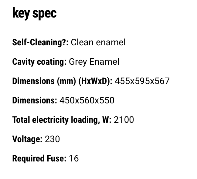

I've just received an email from a customer that I'm in the process of quoting for electrical mods is part of a kitchen re-fit.
When I first talked to them they were talking about having an induction hob rated at about 7.5KW and a single oven rated at 3.5KW. As a rule of thumb I usually say its OK on one circuit when diversity is applied as described in the OSG - and I usually make sure there is no socket outlet on the cooker control. If its a double oven I would recommend an additional circuit be installed. In recent years I've noticed an increasing trend where the manufacturer fits a supply cord to the oven (most induction hobs come with one too). Problem is that the oven supply cord is usually a bit of 1.5mm 3 core flex, and I cant really connect this directly to a 32A supply without first fusing down to protect the cord (not to mention the internal oven wiring). So I usually need to install an additional bit of circuit protection somewhere to protect the oven. I know that every electrician has a slightly different approach to this issue. And I've seen some very creative (dangerous) installations too.
Anyway, I have a question which has just arisen. The customer also wants a microwave-combi oven to be installed. They sent me the details of the load requirements of the appliance - 2.1KW. All sounds fine so far. I'm thinking well that can probably just go on a 13A Switched fused spur. However the manufacturers instruction calls for circuit protection to be 16A? So now I'm looking at a new 16A radial just for the microwave. Does anyone know why they would ask for an appliance that is pulling less than 10A to be on a 16A supply? Maybe it's a European thing where the wire using radial circuits only. But if I deviate from the manufacturers instructions that's a non compliance according to BS7671.

Probably because BS 7671 advises that any load of 2KW and above needs to be on a dedicate circuit
Hi - fwiw I’d have used the DP switched 13A fused spur too … can you advise the microwave make and model? Nowadays, I think we are required to consider manufacturer’s instructions but not to follow them blindly.

Its a Zanussi ZVENW6X1.

Hi - looking at their spec, it seems the unit may draw about 9A and so a 13A fuse would seem a safe alternative to their recommended 16A.
