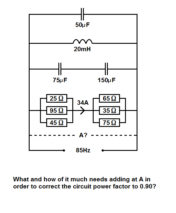

Here's a nice little juicy one to get your teeth in to :)

Selling maths as anything is a tough one. Surely one of the students can make a start, resolving the resistors into a single resistance is an easy first step.
Hi mate, spent a fair bit of time with this one. My answer would be that A should be a resistor of value 368.49 Ohms to provide a power factor of 0.90. I think I'm pretty confident with this one, as have been grappling with my calculator to check it. I look forward to hearing from you. Cheers J
Just to check I'm going in the right direction, is the power factor initially 0.98 before trying to correct it? As this is what I've calculated so far.
No, as in any real life situation you are always trying to achieve unity or at least close to it. Sometimes allowances are made so that you don't tip the other end of the scale and as such you will find a selectable value on all PFCUs. This is a value you can choose to correct the PF to.
In this example, the existing PF is lower than the value I ask for it to be corrected to.
I can't think of any case where you would want to achieve a lower power factor :)
