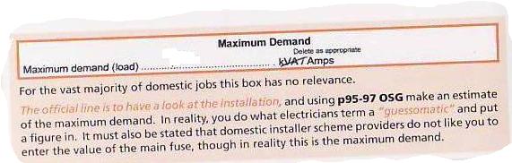

[ElectriciansForums.net] maximum Demand/ DiversityJust somthing in one of my books
