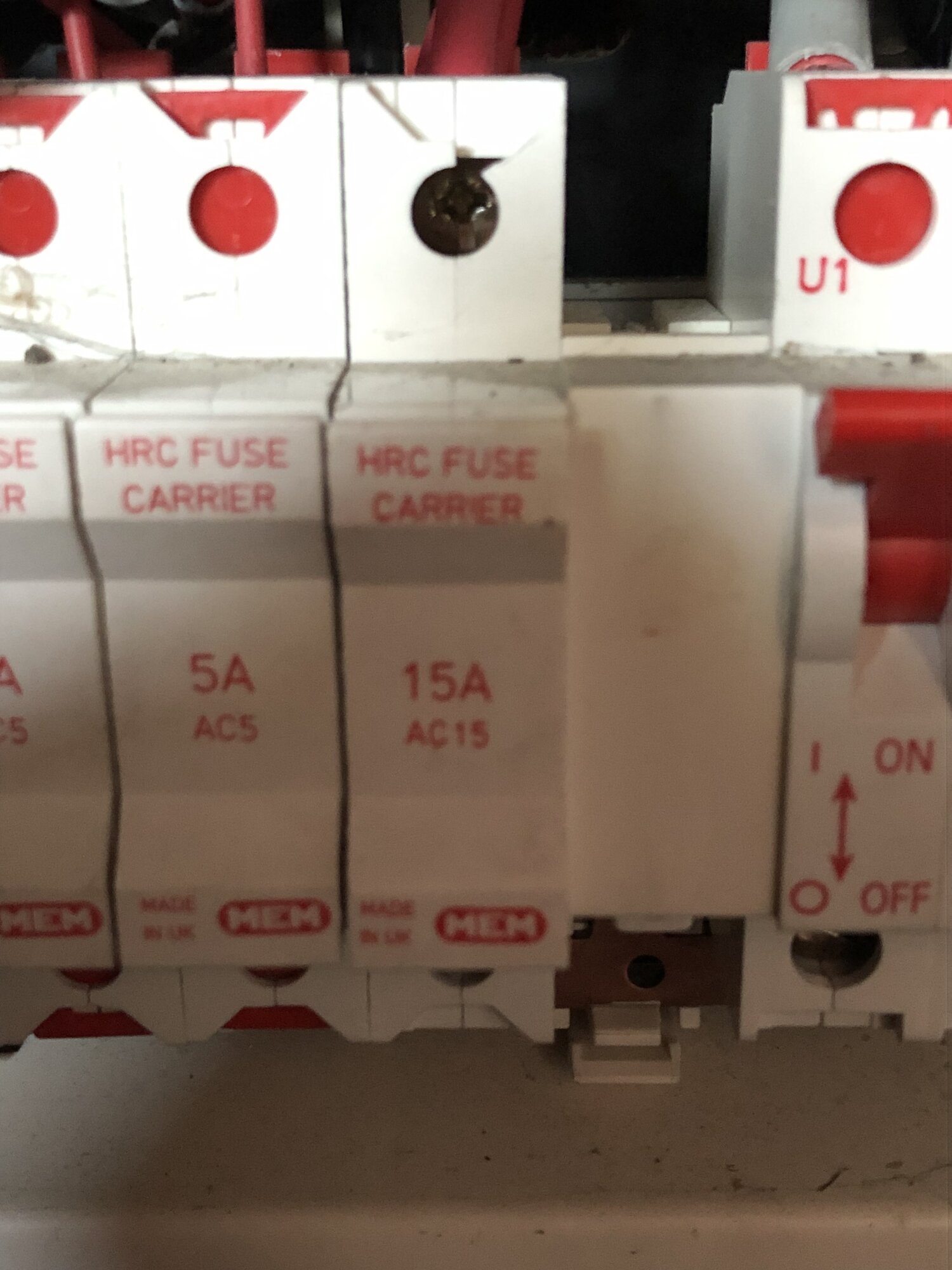

Anyone point me in the direction of what MCBs will fit this board ? Thanks in advance

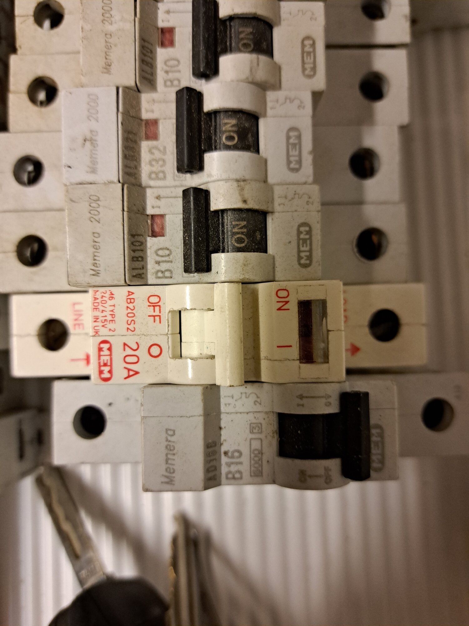

I have one MEM MCB of a similar vintage but have no idea if it will fit that CU.
Not much use I know but the newer, black lettered, MEMs are very different from the older red lettered ones.

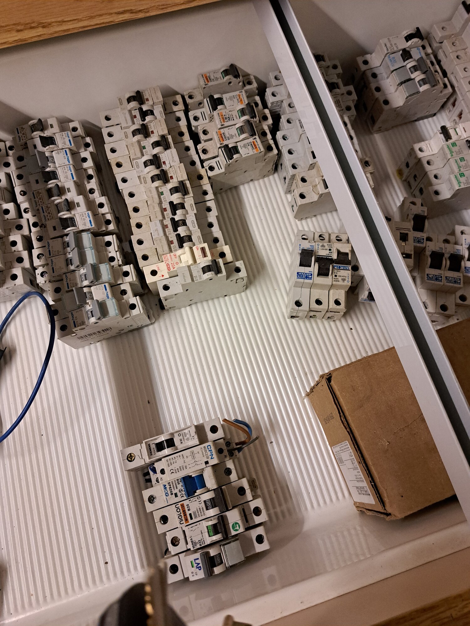

  • [ElectriciansForums.net] Mcb to fit MEM fuse carrier

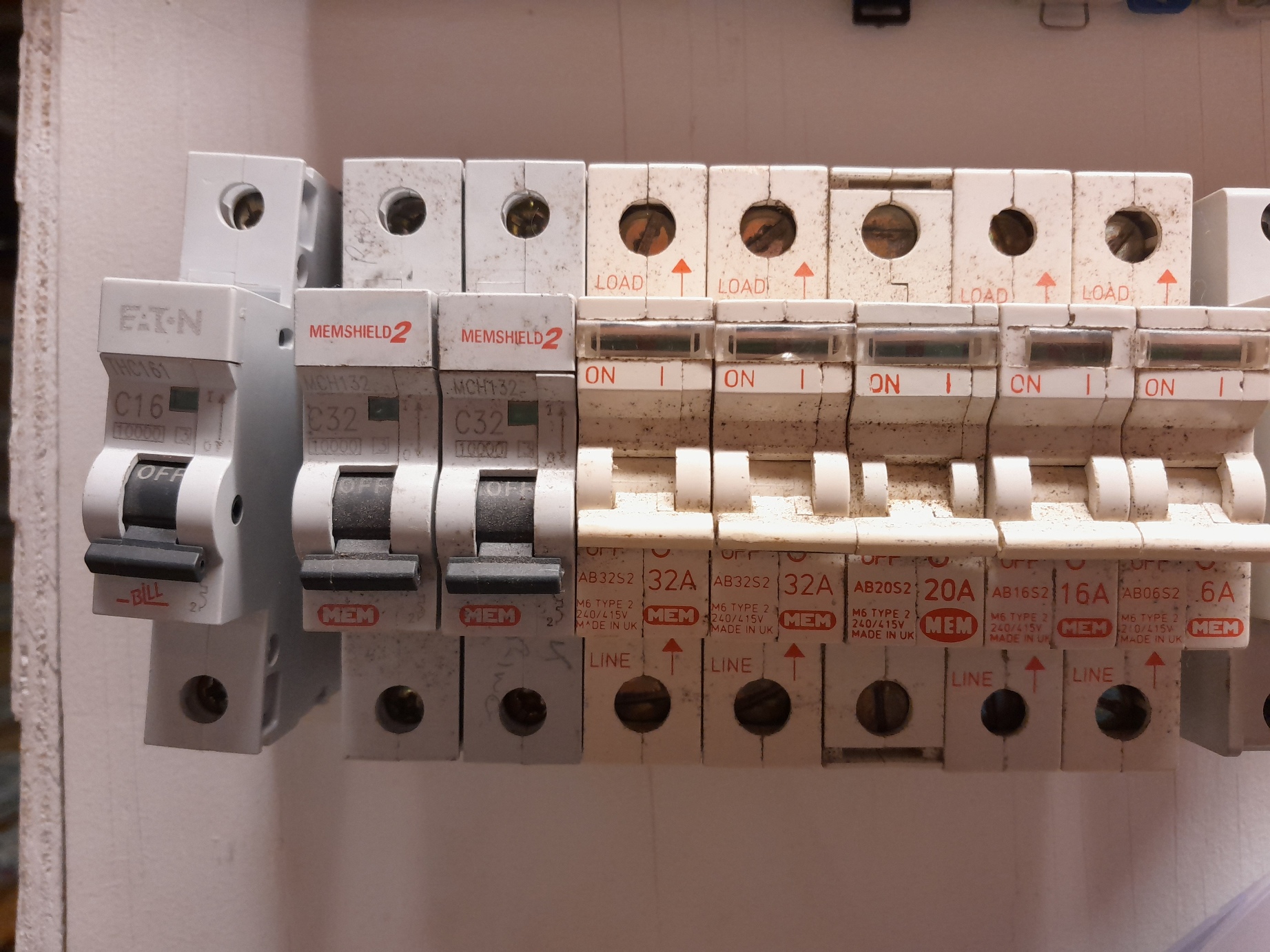

I agree I'm almost certain these are just an early version of Memshield 2. Looking at the various MCBs there have been a number of small design changes...
There's also the 'commercial' range, which were branded 'Bill', if my hazy memory serves me right.
They're all interchangeable, except that (IIRC) at some point the 'fingers' on the bus bar were reduced in width, and later devices won't fit the earlier bar.
