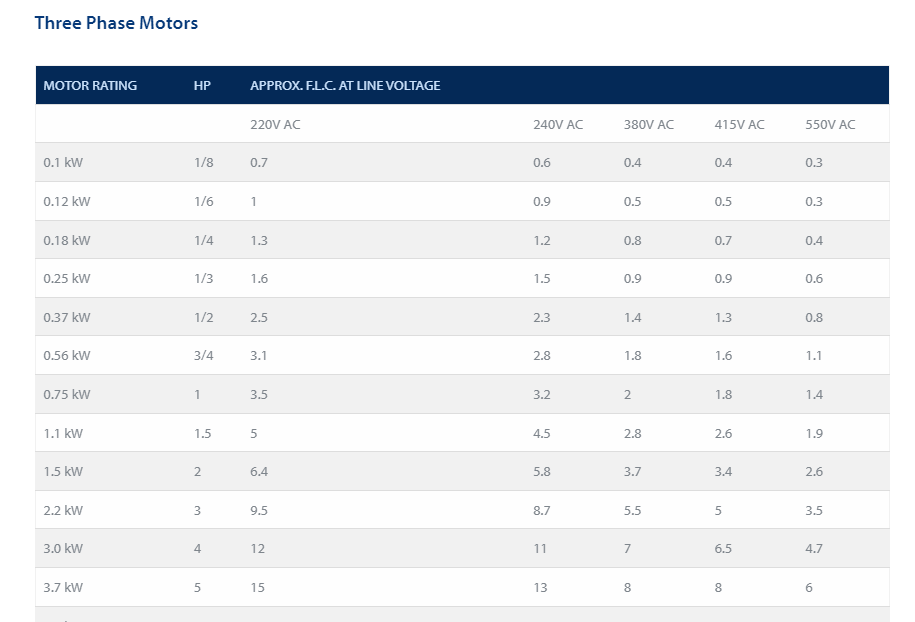

Hi All,
I have a FCU rated at 1.1 kW (3 speeds) but stating 2.8 A (FLA).
Can anyone explain me what FLA is and why 3.8 A? If I make my maths: 1100 W / 230 V is 4 78 A.
Not sure what I am doing wrong. Thank you.
Mark
Can you tell us what you mean by FCU, over here (UK) if often means Fused connection unit.
1.1kW and 2.8A works for 400V but it would be unusual for a single phase load to be connected phase-phase.
If you look at motor current charts the FLA does state its 2.8A for a 1.1kW motor at 380Vac.

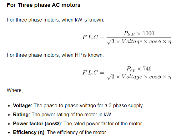

1100 / (400 * sqrt 3) should be 1.58 A. Not 2.8 A.
Not sure what I'm calculating wrong.
Thank you
There is also the Power Factor and Efficiency of the motor that has to be taken into account.
Correct... even if I wanted to consider 0.8 for both PF and efficiency... I dont get anything grrater than 2.5A.... ?
Is there no plate on the motor telling you the Efficiency and Power Factor?
I think my confusion comes from the fact I don't know the definition of FLA or FLC.
Also, have a look at this picture.
I cannot figure out the maths to confirm the current given once I have voltage, power, power factor and efficiency

For some reason I thought that a fancoil only had 1 motor: the fan. But ot seems that this plate differentiates between motor AND fun. Not sure to understand the difference. But if I put some numbers is.... 1.5 kW; 400V; 0.83 eff; maybe a 0.8 PF... we will get more or less the 3.42 A stated.
