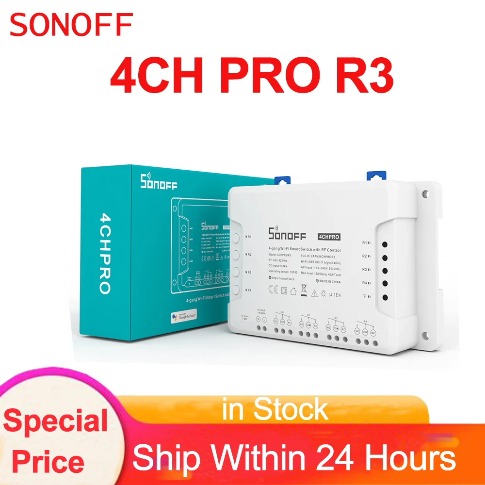

At a simpler DIY level I see Sonoff do an 8 channel transmitter, and 4 channel receivers, and they are reasonably priced compared with other light switch type options.
So eight of these(!) and two appropriate receivers (below)
And two of these: SONOFF 4CHR3/PROR3 - 4 gang 433Mhz RF remote WiFi smart switch - https://sonoff.tech/product/diy-smart-switches/4chr3-4chpror3/
Chinese versions:
SONOFF-Télécommande RF pour maison intelligente, RSafe33Inter, 8 touches, 433MHz, TX, 4CHPROR3, RFR2, iFAN04, D1, RF BridgeInter - AliExpress 13 - https://www.aliexpress.com/item/1005006806690831.html?
Caveat - needs checking that these will actually do what you want, but at first glance, assuming each remote can be fettled to connect one of its buttons to each of your old-school bell pushes, it potentially could do the job (for 8 of the 9 flags) 🤔
Yes it absolutely can be made to work, it just depends on how much money you want to spend on it.
Fair point, but you can't take it with you and I have set myself this project. The bell and indicator box is over 120 years old and it all works except for the wiring from the call buttons. I hope to get some wiring to some buttons but I know others will be too challenging.
Most RC Model systems work on a bus system now days so minimal wiring, Transmitters are available up too twenty channels and more so that is not the problem, converting the signal too operate the flags also not a problem with mini servo's, the problem is getting the call buttons to interface with a Tx, someone with electronics knowledge could possibly take a Tx to bits and hide the channel operating button behind the call point, but distance cold be the downfall.
