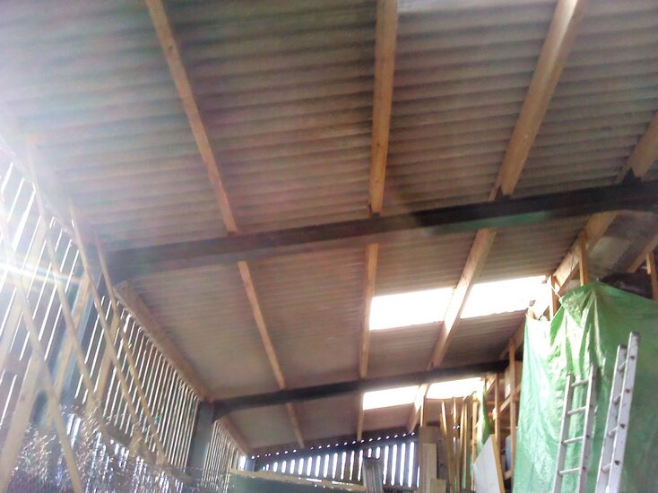

We are currently looking at an install on a barn roof that has corrugated 'cement' sheeting on it and we are wondering what is the best way to mount to it, and how many fixing points are required?
We want 2 rows of 8 landscape panels. Here is an image of the roof.
The spacing between the wooden beams is ~1200mm
[ElectriciansForums.net] Mounting to corrugated 'cement' barn roof?
What method of mounting would you suggest? Hanger bolts with vertical rails?
PS. We will check if the roof has some asbestos in, so please don't focus on that.
Any info would be much appreciated.
Will
I'd be amazed if the roof didn't have asbestos, but don't let it stop you if does have.
I'd go for hanger bolts directly into the timber. A pretty straightforward install. For God sake make sure you use crawling boards.
You can normally get a idea from the year when the sheets went on as to what they are likely to be , but they look like fibre to me from the picture that is ?
If you are on wooden purlins in our experience it is absolutely imperative that you go for hanger bolts , so that you can take out the undulation of the purlins , the roof may look flat but when you start putting any decent sized systems of a reasonable length up there the difference will stand out a mile !
We always cross rail on wood as well.

Has anyone done an installation on concrete purlins, the type with the lip for the j bolts to hook onto?.
I'm thinking j bolts, with a rubber washers in the hole, them a large metal washer/spacer above to spread any movement and protect the asbestos. then the plate then the rail. It;s not exactly off the shelf and doubt you will find it in any PV manual. But i've done a test and it is as solid as a rock.

One other thing, you will need to have a structural survey on the roof and it will fail.
The timbers used are unclassified, so a structural engineer has no specifications from which to make their calculations, they need to be at least C16 timbers.
If the barn is pre 2000 it may well have asbestos, after that it should be OK.

Ive been a commercial roofer for 20 years, you cant tell by looking at a panel wether it has asbestos in it or not, unless your lucky enough to find the Eternit ones where they are stamped or sprayed with identification on the side lap. Get it tested - i know some unscrupulous people who were selling old asbestos sheets even after 2000!
You need to net the underside or work from harnesses clipped to a running line on the walk board (only harness if over 4m from the floor as harness is no good under 4m - you'll hit the floor before it stops you ) if you dont and you have an accident or the HSE turn up first then good explaining your way out of jail - they are not very receptive to people trying to flout the law or plead innocent to not knowing the rules as you should be competent to carry out the works.
Your right about c16 timber, proving it will be almost impossible, if your going to go ahead then just hope MCS dont decide to come checking!
Concrete purlins is a difficult one ive fixed steel angles to the sides before with tapcons then used standoff bolts from the angle (cant do that on prestressed purlins), your way doesnt sound too bad, you want a Dowty washer on the top side of the roof, you could chock the gap between the purlin and the underside of the sheet with timber but thats a pain, just dont apply any weight to the roof sheet as it will crack.
Final point make sure you tell the client your not responsible for any leaks or damage to the roof post install as its virtually impossible to work on a asbestos/fibre roof without damaging it.

I can tell you for a fact it will fail on the structural calculations , well i have happily not found a engineer bent enough to put his name to one yet !
The best way to do it is to come off / around the rafters with a site fabricated bracket then through the sheet with large stud and fix your rails to that , you will need a beefed up cross rail but one advantage is you do not need to matrix the fixing rails as you will now be able to come through where you need them !
You can get it all from Regent Green Engineering just ask for Alan (Bloody top bloke). I know he on holiday this week though !
He may even come out and measure up the brackets for you .
Or you could offer to re sheet the roof and install zed purlins alongside the old concrete ones , the zeds are slightly larger so it essentially make the concrete ones obsolete .
