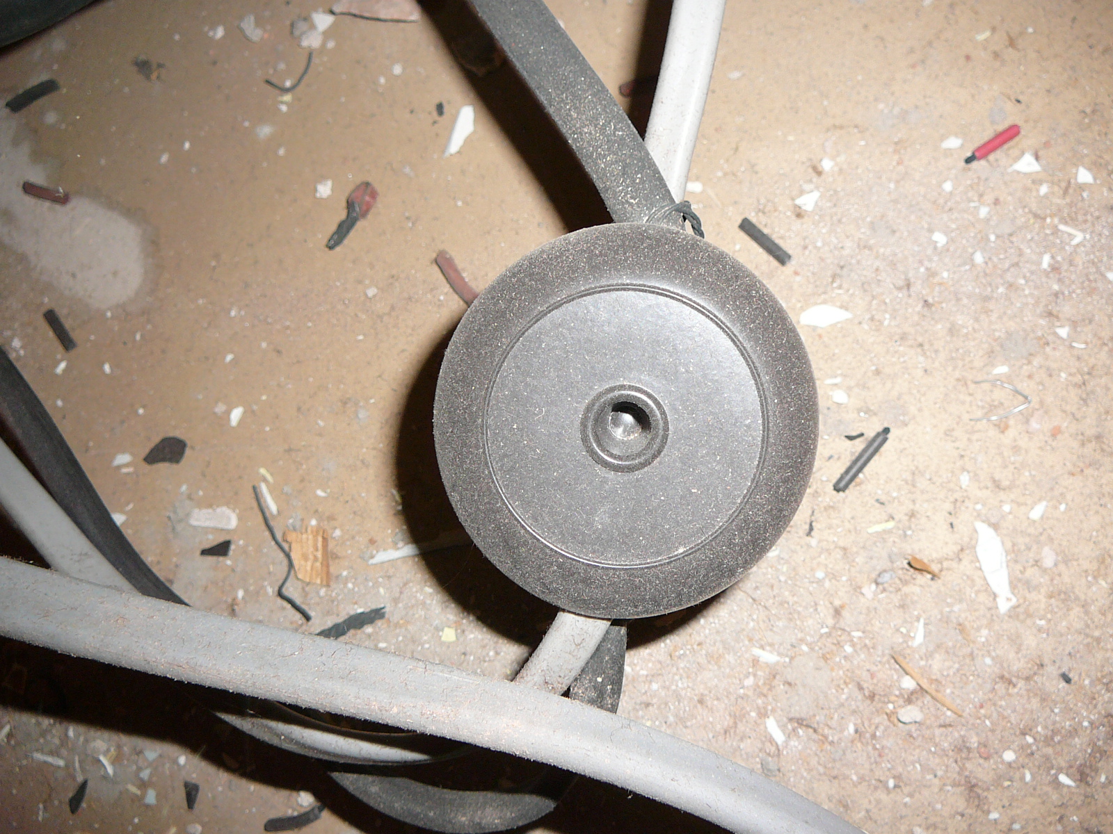

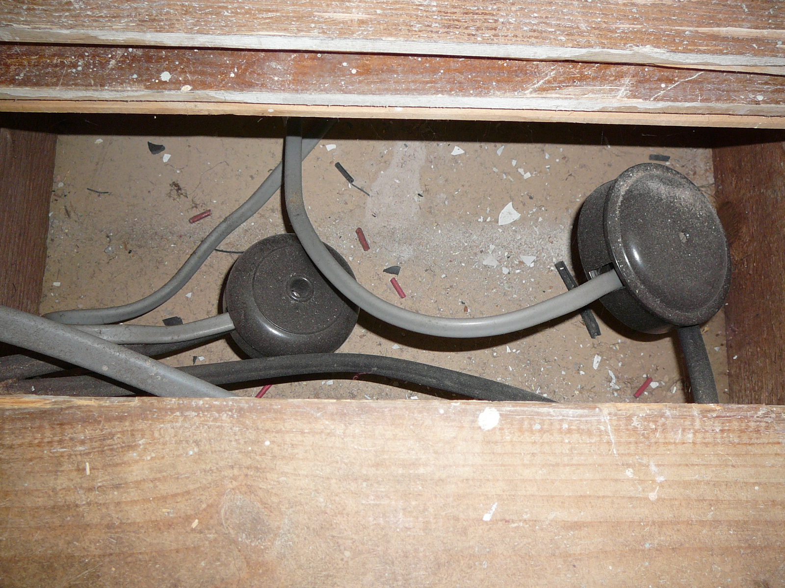

Needless to say the damaged socket was replaced. I have many more disasters found and undoubtedly given the quality of what I have found so far more to come. My most serious worry is loose terminals in junction boxes under the floors (there are many spurs with no apparent source) that are now unfortunately covered with wretched laminate flooring over the floorboards.
