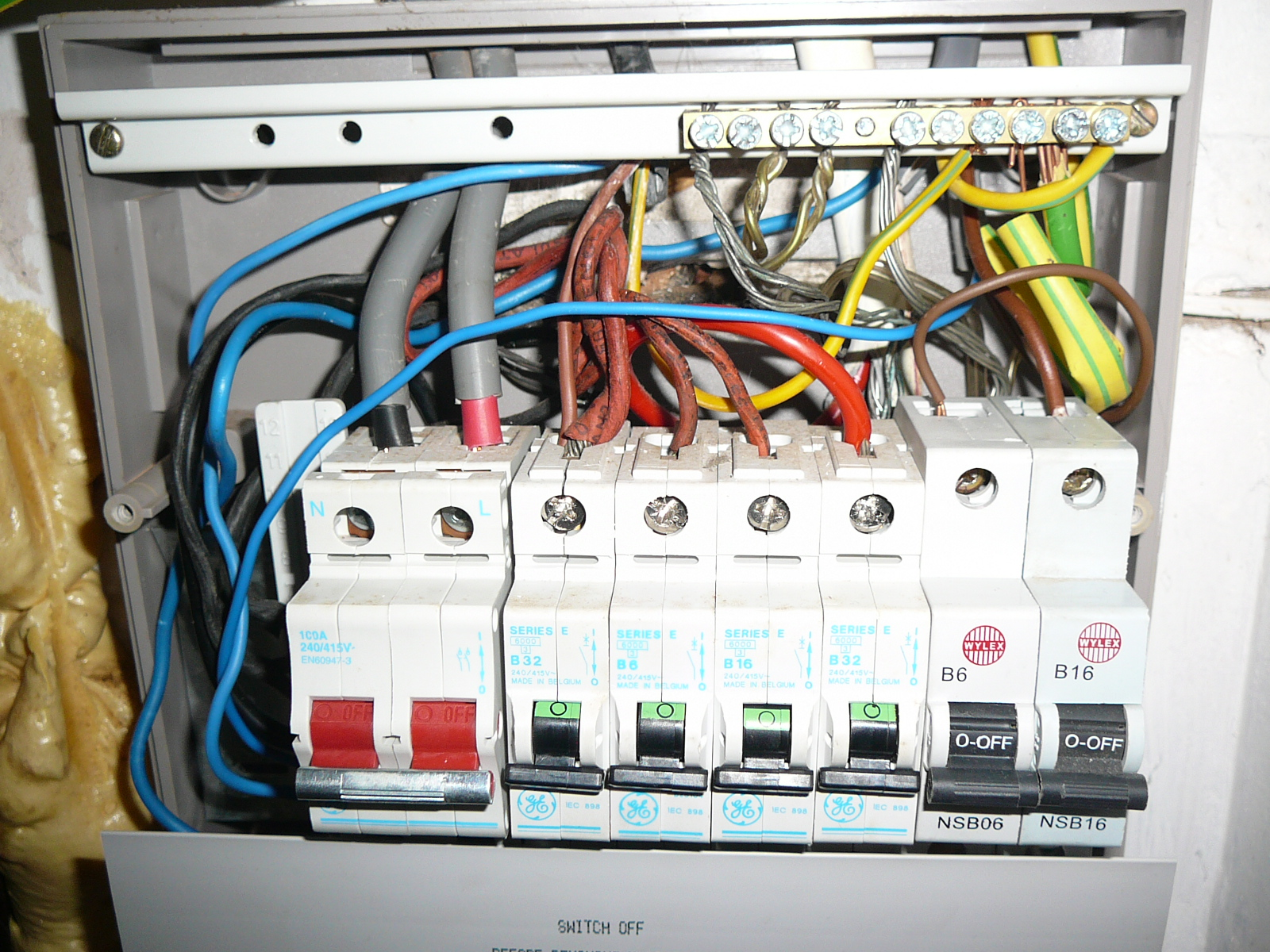

Obviously some work has been done on the circuits as I note that there are two circuits in Brown that presumably the Blues belong too, but two Browns and Three Blues?
You missed one of the browns, probably the one in the 6A with the two lighting VIR's.

Must be my eyesight, but I can see three cables into the B32.
There was when I first arrived, the 6A flax to the double socket was in the B32 till I moved it to the adjacent B6, are you looking at the recent picture in this thread after the move was done or in one of my other threads before the move of that wire I wonder.

Ahh yes that is the earlier more deadly picture!
If you look at the picture in post#39 this thread that nasty piece of 6A flex has now been removed completely along with the double socket it was feeding. And as described above the 2nd VIR lighting feed has been moved from a 16A to the same 6A as the other lighting feed.

But looking at the closeup in post#17 I think you may be right, it does look like there are 3 pieces of VIR in the 32A, I dont want to disturb it to look closer but I assume this may be a local spur connection.

That's the problem with not updating the picture in the next page, I had to go back a page and looked at the first picture I came across, this thread and the others you have running do not lend themselves to getting consistent answers, stick to one thread concerning one subject to make it easier for people to try and help.

The only plus really about the pictures is that the insulation in the consumer unit appears to still be in place - I've seen much worse still live in a current property where the insulation is literally dust.
