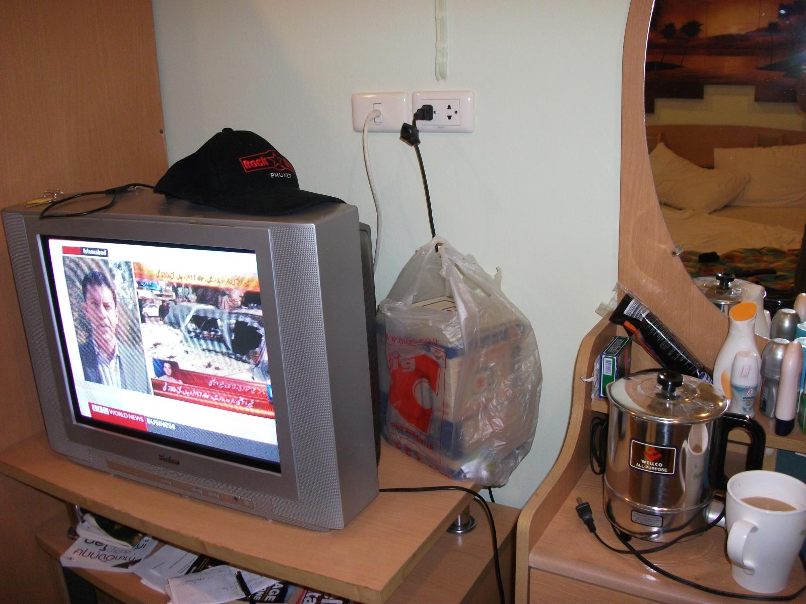

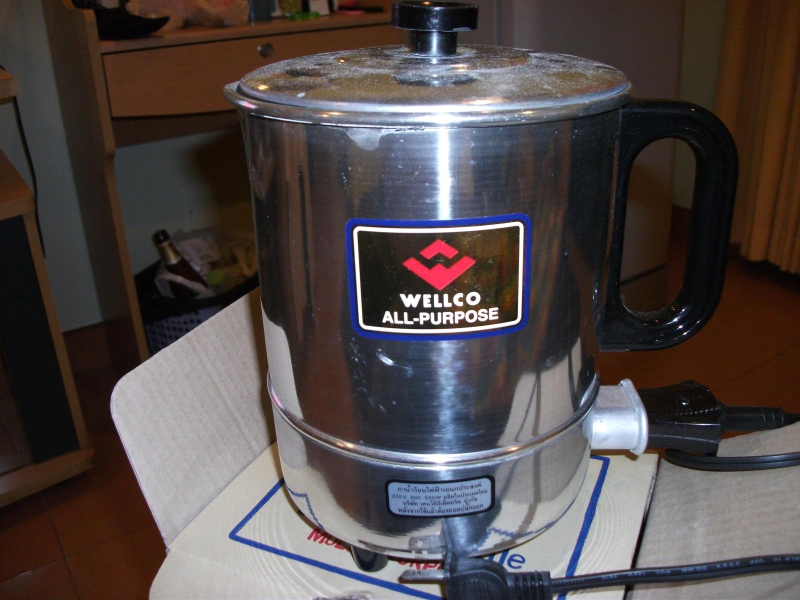

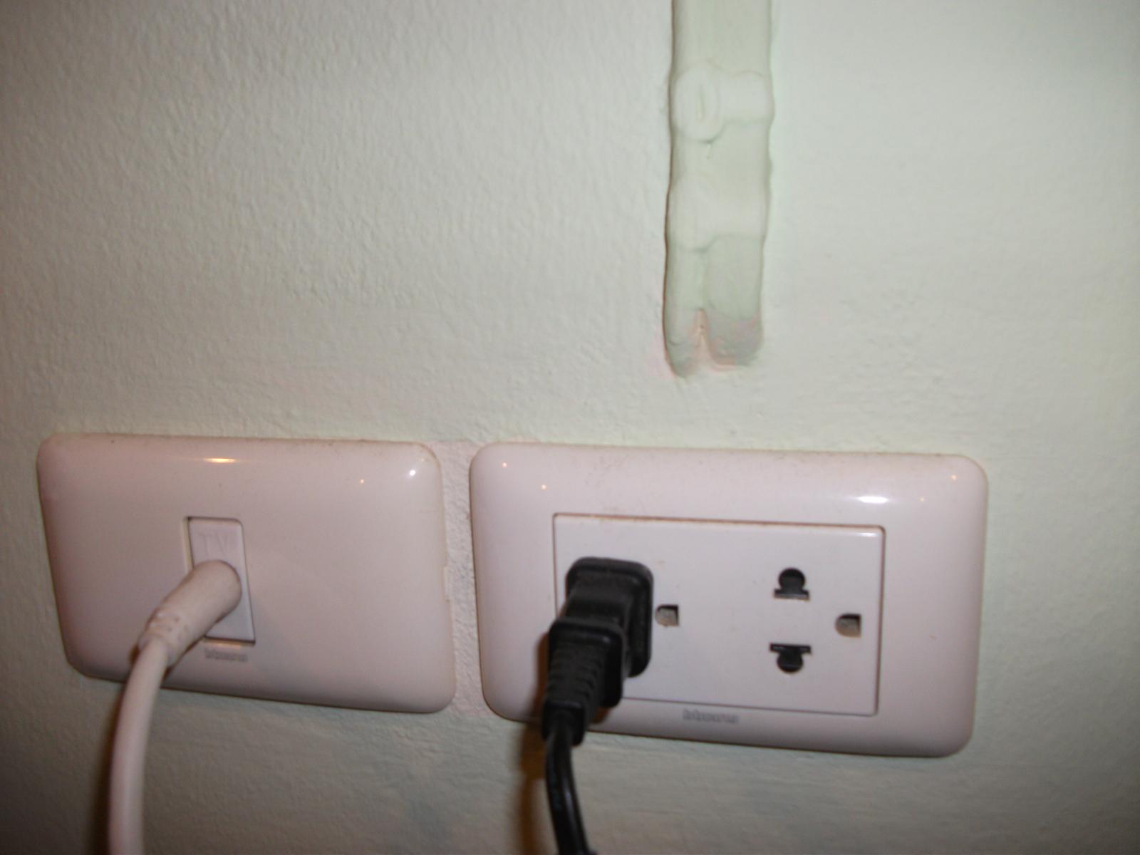

hi guys just bought a new kettle trom big c here in phuket , its aluminium , as u can see it has twin flex, so no earth!! theres no switch,either on the kettle or any of the sockets here
2yearsago a thai girl was electrocuted by this type of kettle, which developed a live / earth fault ,she died- lots of people die this way here, there IS an earth provided on the sockets but they don,t normally connect anything to it i,ll post more stuff later nice e,h!! [ElectriciansForums.net] my new thai kettle[ElectriciansForums.net] my new thai kettle[ElectriciansForums.net] my new thai kettle

What ...and No RCD's either??...lol!! They don't normally connect anything to the earth pin of the sockets, because most appliances (like your spanking new kettle) all come with twin flex and 2 pin plug tops!! Just needs a little nudge from government, requiring all class 1 appliances and equipment be supplied with suitable cords and plug tops. It's exactly the same here, but i have seen things gradually changing over the past 5 years or so... lol!!!

As Kenny stated, no difference to what you would see in India, and a good many other Far East countries. It's the same here in the shanty towns, but seems to be improving, abeit slowly!! lol!!
As for the guy working, ...they don't seem to have the fear that we Westerns see, and have certanly little to no H&S provisions in place. We have to stop this kind of working on a daily basis at our project. You have to literary threaten them with being banned from the site to get them to listen and to take any notice of you.. It's all in a normal working day for them!!!... lol!!!
