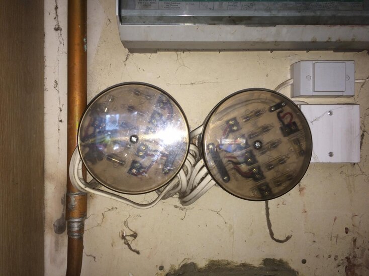

Got sent this photo today:
[ElectriciansForums.net] Name the manufacturer
Can anyone name the manufacturer? They date back to about 1990
Thanks
Yes, widely used for 12v halogen lighting when it was first introduced. The big problem with them was volt drop on the secondary side wiring, it was vital that voltage at each fitting was a constant 11.something volts,and this lead to the ridiculous scenario of 2.5,4.0 and even 6.0mm cables feeding one lamp if it was not possible to mount the transformer close to the lamps.
I've seen those exact trannies before but cant remember the make. Best option if they have failed is link all the cables to the 230v supply and fit an electronic trannie at each light if they still want halogen,or convert to LED.

I actually did it with a 4 core 4.0mm swa last week!
