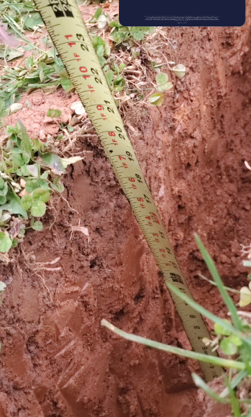

I received multiple quotes to install a long run for my electrical outlet NEMA 14-50 for my tesla. The cost is huge $1800 give and take.
Basically it will be in the drive way running from the electric panel in the middle of the house to under the floor to the crawlspace (20ft), then under the deck (40ft) then continue to the siding above ground for another 40 feet before going under ground another 50 feet to the drive way.
I am going to cry, lol.
Thinking of diy. I do not mind digging running cable. Probably use some 34" liquid tight flexible non metallic conduit that my friend gave me to run in the crawlspace to outdoor outside then use PVC to go 18" below ground to the Nema 14-50.

Completed my Pedestal with NEMA 14-50, charging at 32mph. Passed rough in inspection first try. Second try failed, I had to install ground rods., on going.
