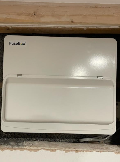

I'm actually still finding a fair few without RCD in this area. This one had a useless standalone RCBO which only fed an abandoned shower circuit, bare ends taped up in loft still live. I just managed to get a Fusebox RCBO board in the space. I wanted to fit a Hager flush mount with adjustable depth but the customer didn't want it 'on show'.

That does look a tight fit! The original Wylex box is a C2 fail on account of the missing fuse cover. Even if the lone rewireable had been replaced by a plug in MCB, the cover is still required with the front face removed for the MCBs to project through.
