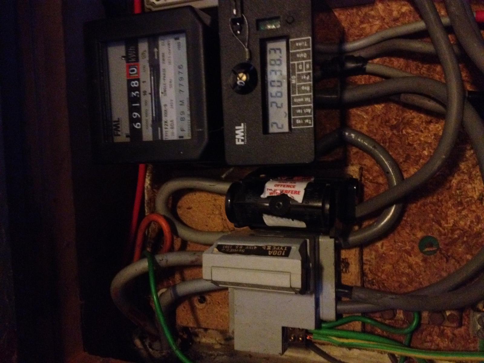

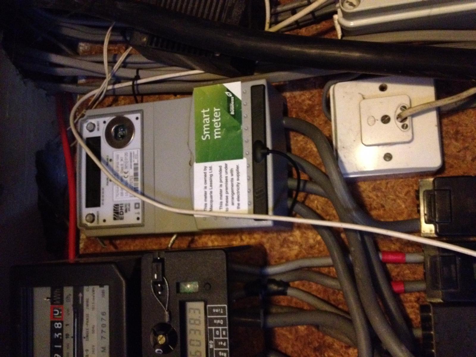

Clamp tested the incoming and found at the time it was drawing around 135Amps, now the fun bit! The incoming cable goes into the 100Amp main fuse, then has a split from the supply side into another 100Amp main fuse (2 x 100Amp main fuses being fed from one supply, single phase)

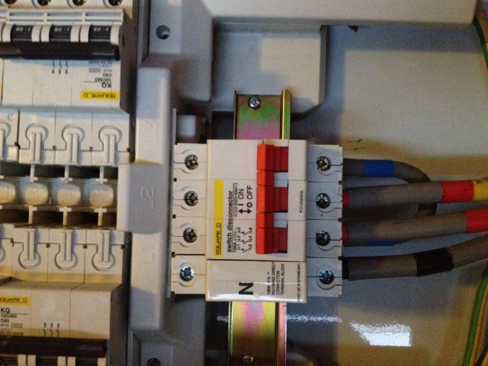

One Fuse then supplies one meter and the other a second Smart meter, both meters then go down to feed a Square D 3 pole 125Amp Main Switch, the third pole is linked to the first pole on the switch as its a three phase board (single phase supply)

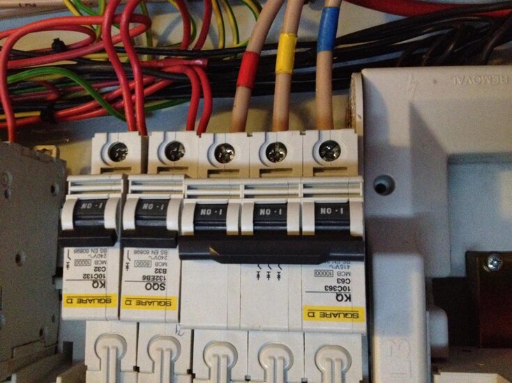

All the circuits fed from this DB appear fine and are drawing as a total around 20Amps (lighting, sockets, Fire alarm etc) There is however a Three Pole Square D KQ 10C363 63Amp MCB feeding a five core 16mm SWA which supplies DB2 in the kitchen, this is drawing around 95AMps (split between the three poles, other two cores are Neutral and earth)
Checked the regs for a start and the 16mm multi-core SWA is rated (clipped direct which it is not) @ 77Amps (it is fed through the wall and i would guess through the ceiling void ground floor.

Cheers for the replies, as i said the pub is way out in the sticks, Supplier has quoted around £30k for 3Phase install (so i m told) I v never got involved with 3Phase first question is the current setup with the supply to the kitchen, the MCB is rated at 63Amps i assume that this is per pole, otherwise it would have been tripping with the 95Amps loading, also the cable is rated at 77Amps This is the total loading of the cable not per core, i know stupid question but its just bugging me that someone would actually install that.

This is the 125Amp Main Switch

Strange use of colours for single phase, anyway. I would check the neutral, looks like its three into one.....LOL.
The cable is rated at 70 odd amps but it looks like you are spreading the load over the phase cores (well L1 anyway) and returning the lot over one neutral.

now i.m confused. the supply to DB2 is 3 phase according to your pic.
What he appears to have is a 3 phase isolator supplied by 2 single supplies
One metered supply for 2 poles (there is a link across the poles) then the other metered supplies the third pole

Can anyone suggest reasons why the Supplier has fitted the two meters and split the incomer like they have? I will put up another pic. of the other meter.

Ye thats exactly what it is, the three poles from the 63Amp MCB all supply DB2 (again into a Three Pole MCB) all returning down one neutral (16mm) This cant be good practise?
