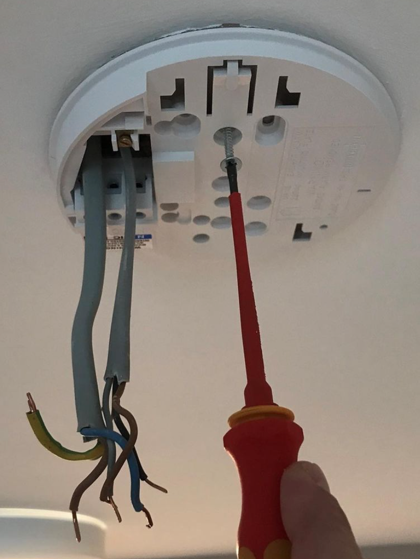

Thanks for your reply. I'm mostly interested in your experience with existing devices, and what do you think about existing terminals. We're thinking of changing the screw terminal to wago style terminals.
Using Aico I often swear as the entry points for the cables are set in a square cage and small one at that so getting the cables in to the terminal is made difficult as they are hard to get at. Wago might be good but you need a straight entry into the terminals whatever the method of termination. Push fit would be good. You get them a lot on lights and when you are doing eighty lights it makes a hell of a difference. Detectors on fire alarm systems can be problematic. FP200 being so soft is prone to damage when attempting to make sure they are below the level required in order to get the detector to fit on the base. Screw terminals require a level of dexterity that is not often encountered in my trainees which results in lost screws. Although you should not really have to take them out it happens that inexperienced turn the screw too far and whoopsy, screw gone. Push fit would again be good.

I only ever fit aico… and find their connections lacking in space. Not the terminals, but the space needed for the tails.
At most, it should only be 2 x 3c&e, but sometimes you might need a 3rd cable in there if spurring to an additional detector. Normally that means an extra wago box in the ceiling above.

Thanks, pretty well aware of Scottish regulations and about sealed batteries as well. Still quite not sure how do you connect 2 x 3c&e or 3 x 3c&e cables? If the wires come just from the ceiling, do you use additional wagobox somewhere near? Maybe you can share a photo?)

As has been said the area for dressing the wires is a tad small on these especially when faced with 3 cables which does happen on occasion. Lining up the cable entry onto a fastfix box can also be more difficult than it needs to be too!

You say that lining up a cable entry box with a detector hole is a difficult process. Is it because the hole is not in the center of the base? Or it's just because the detector base hole is just not big enough?

On the Aico ones it can be. It's due to being off-centre and there being too many hole options on the bases. I've found a few times that if I've had to replace a new style Aico base like for like it's common that the last man in had lined up the wrong fixing holes which means the overlap on the cable entry & box is very small. You're then left with the dilemma of struggling to fit the new one the same way or fitting it correctly, having a little more of an overlap but potentially leaving an unpainted bit of ceiling exposed.

I wouldn't usually cut in a box for a smoke detector if fitting off a new install. I'm in Scotland so doing my bit for the LD2 upgrades, particularly for the local authority at the moment, that's where we're finding alot of previously fitted ones with backboxes behind. The reason being that the first detectors were likely the one with the little plugs on the back with the fly-lead attached.
