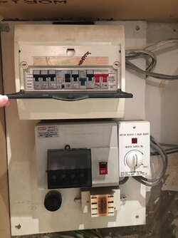

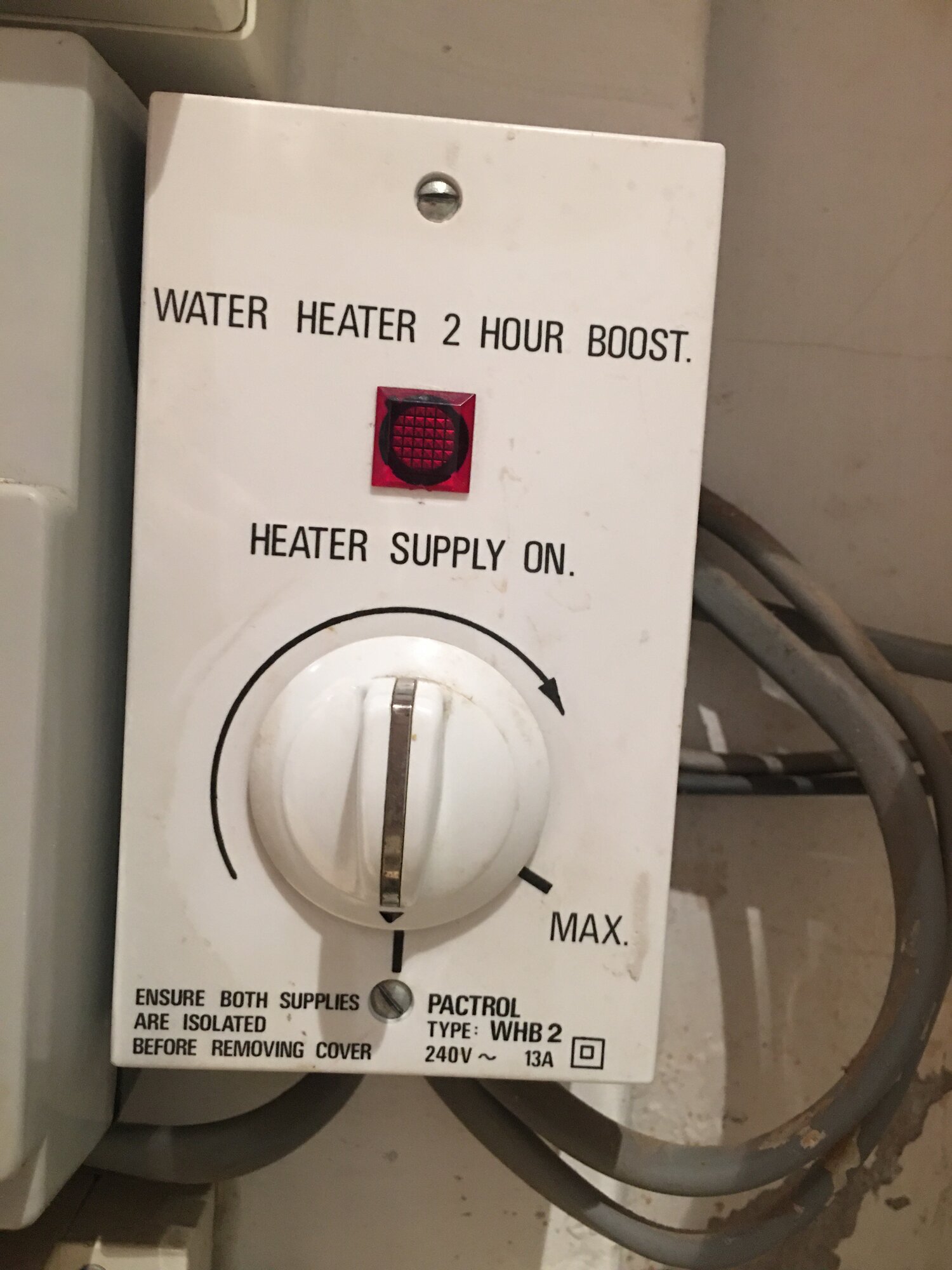

Q.1: we have one switchboard that says “storage heaters and off-peak water heater only”. In the photo, you could see that we have the main switch apparently in an OFF position.is this right? We recently moved up, and we see the ON letters. The question is... When we see the letter ON the switch is ON?
Q.2: If this switch is off-peak only, does this means that the water heater and storage heaters only charge in the night?
Q.3: we never got hot water if we don't use the Water Heater Boost, we don't know is it due to having the main Switch OFF. The water heater has one switch in the cupboard which lights up when we use the Boost timer. Does this light bright at midnight or off-peak tariff?

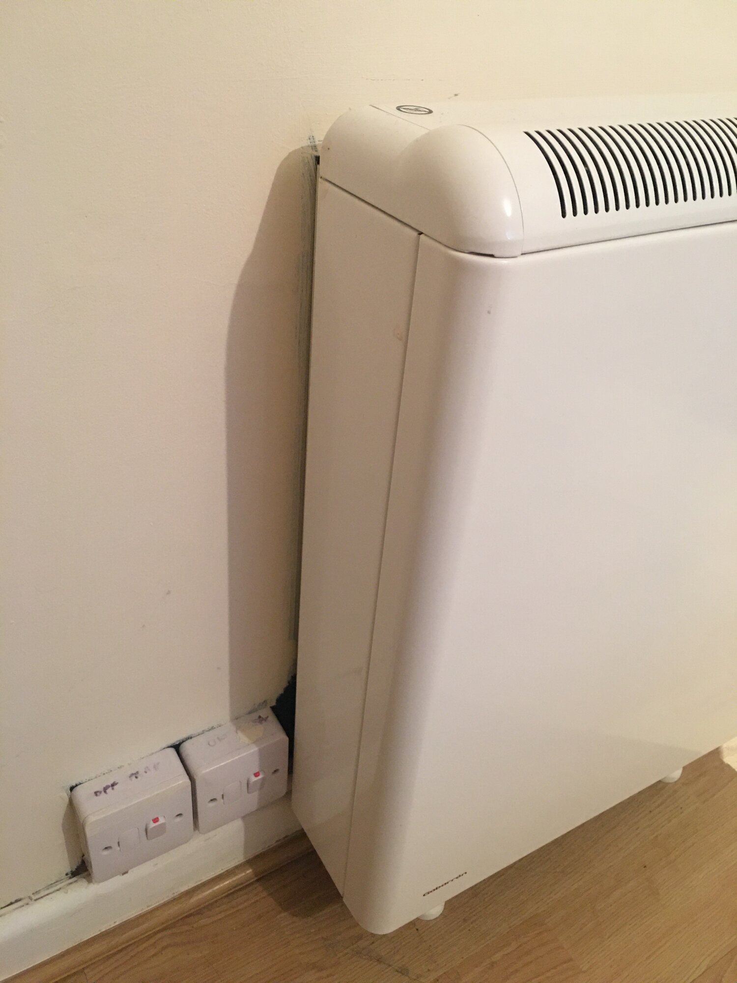

Q.4: About the storage heaters. These are digitally controlled and have two switches, one off-peak and one on-peak. We have the both ON during these days, but we read about the On-peak should be off in the day, and use it only in cold weather, and the off-peak always on. Supposedly this will charge in the night. This is right? Because, again, as we don't know if the switch was ok, these storage heaters doesn't seems charged.

The storage heater board is "OFF" in your photo. I imagine it has just been turned off because nobody was at the property, you should turn it ON!
Q.2: does this means that the water heater and storage heaters only charge in the night?
yes.
Yes - turn the main switch on, and you should have the main water heater element heat the tank at night.

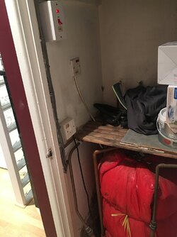

The boost usually uses peak rate (ie daytime) electricity, otherwise the boost switch would no do anything during the day!

yes. The switches on the wall for power into the heater should both be on. Adjust the controls on the heater to mainly use night storage, but you may find you need a little on-peak in the afternoon/evening to "top up" in cold weather.
yes

And just to clarify - your hot water cylinder will probably have two immersion heaters in it, the 'boost' one about half-way up, which can be turned on during the day, and another immersion heater at the bottom of the tank that runs on the off-peak supply, so comes on at night. You will have more hot water available to you with the bottom heater in operation!

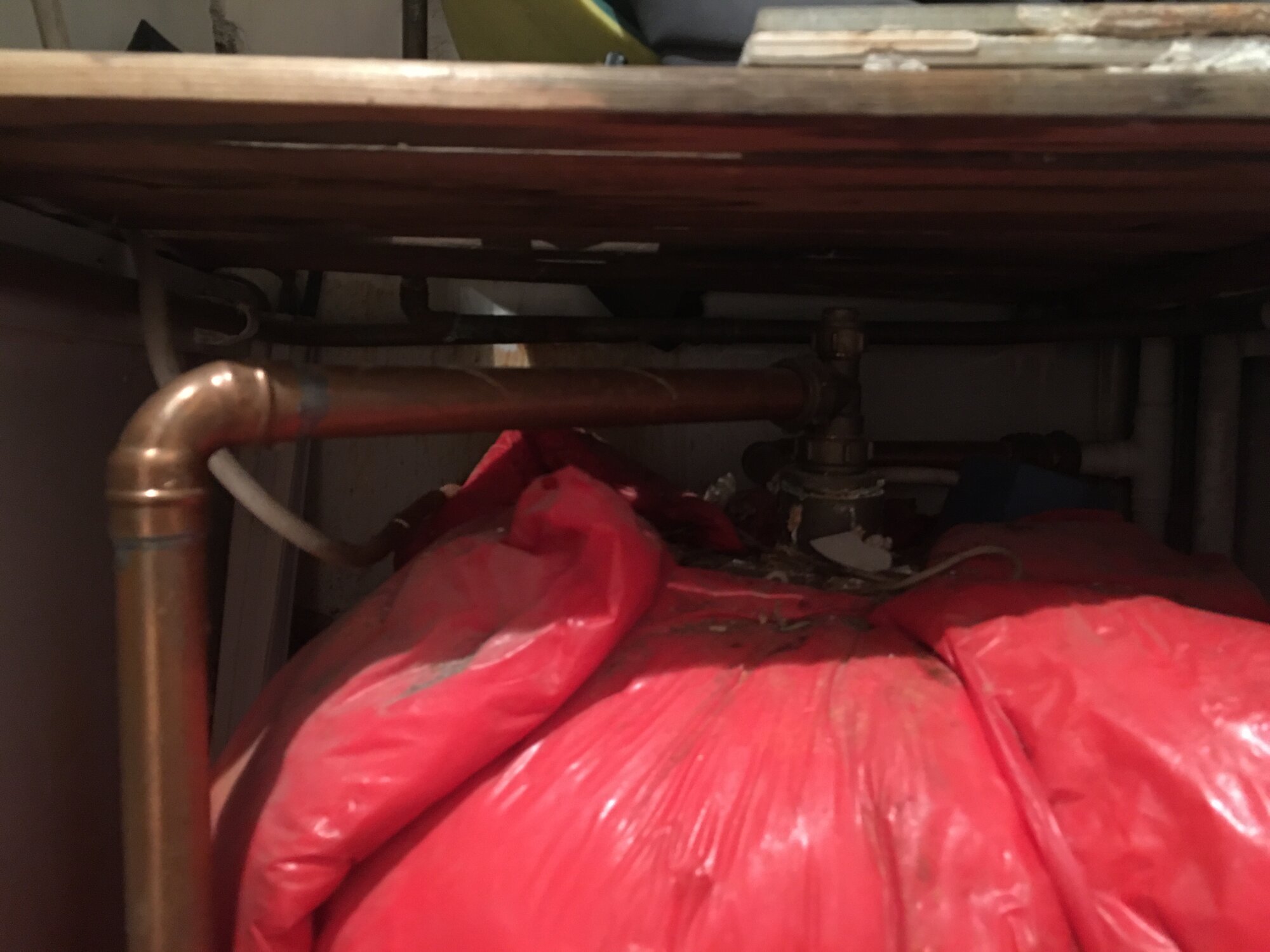

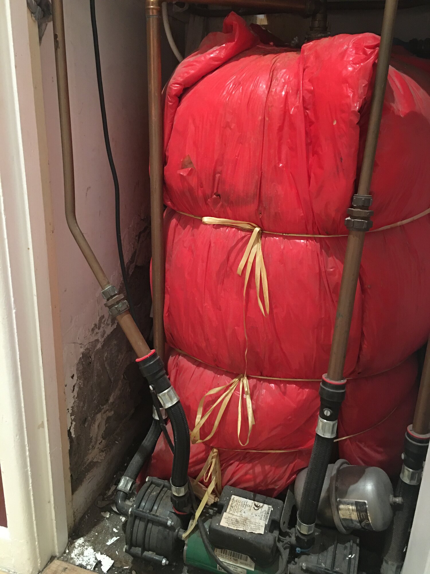

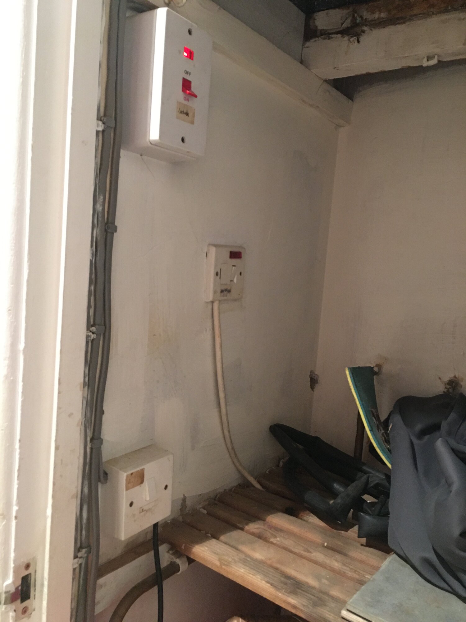

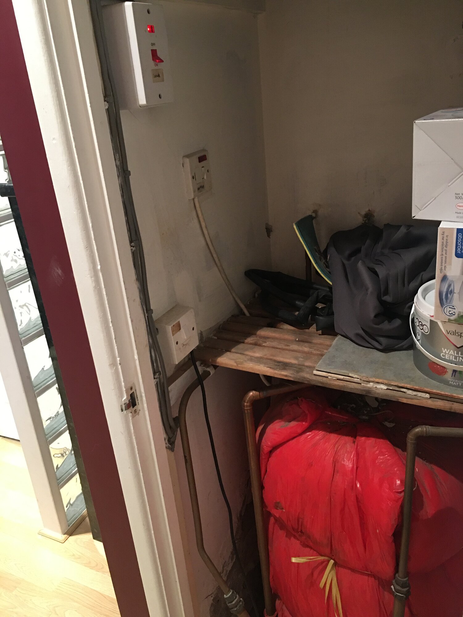

I understand what you say, because I have seen some photos about that. I attach some photos because I'm afraid that is just one switch (with the white wire, connected to the Up side of the water heater). There is another switch Labeled “shower” ( we always let it ON) connected to a third switch that let the water go out. This last switch always is OFF, because we use it just to take a shower, because the handle faucet is just for control temperature.

OK. I see you have an immersion heater in the top of the tank.
So that could possibly be dual element, with a short heater for the top half of the tank, and a long element to heat the whole tank. Or maybe it was once like that, but not any more.
But that immersion seems to have a single cable to a single switch, so I'm not sure what you have now!
See what happens when the off-peak board is switched on!
The boost timer shown has double pole, double throw switching, so can safely be used to completely switch the water heater supply from one supply to the other, and hence can be used with a single immersion heater element for off peak and boost.

Are you saying you switched off the permanent (on-peak) power at the wall? I think that was the wrong thing to do, as there may be a controller inside the heater that needs that electricity to function.
They didn't charge with on-peak either, but when we arrive at the flat there was a middle charge. We did something wrong I think.

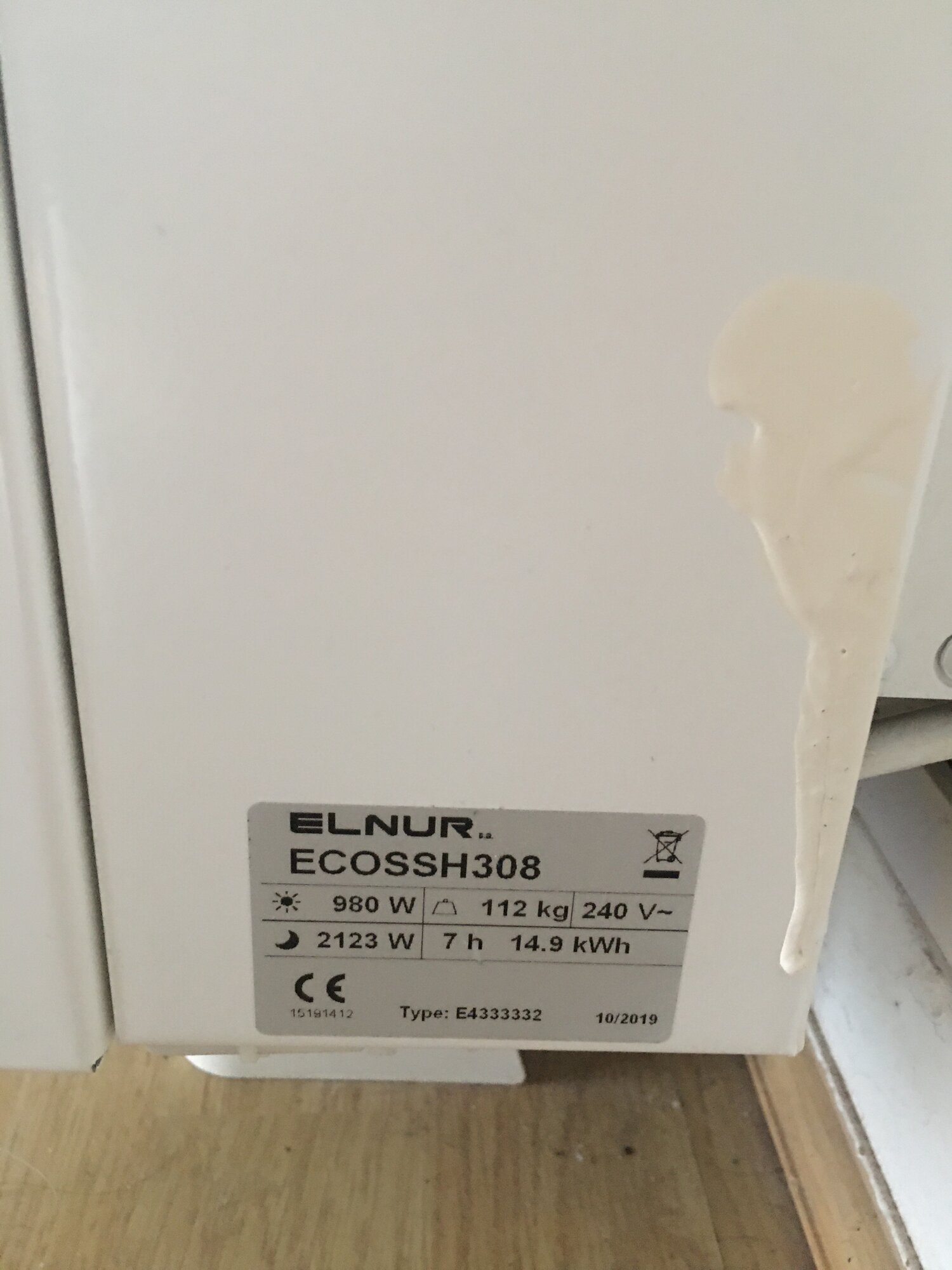

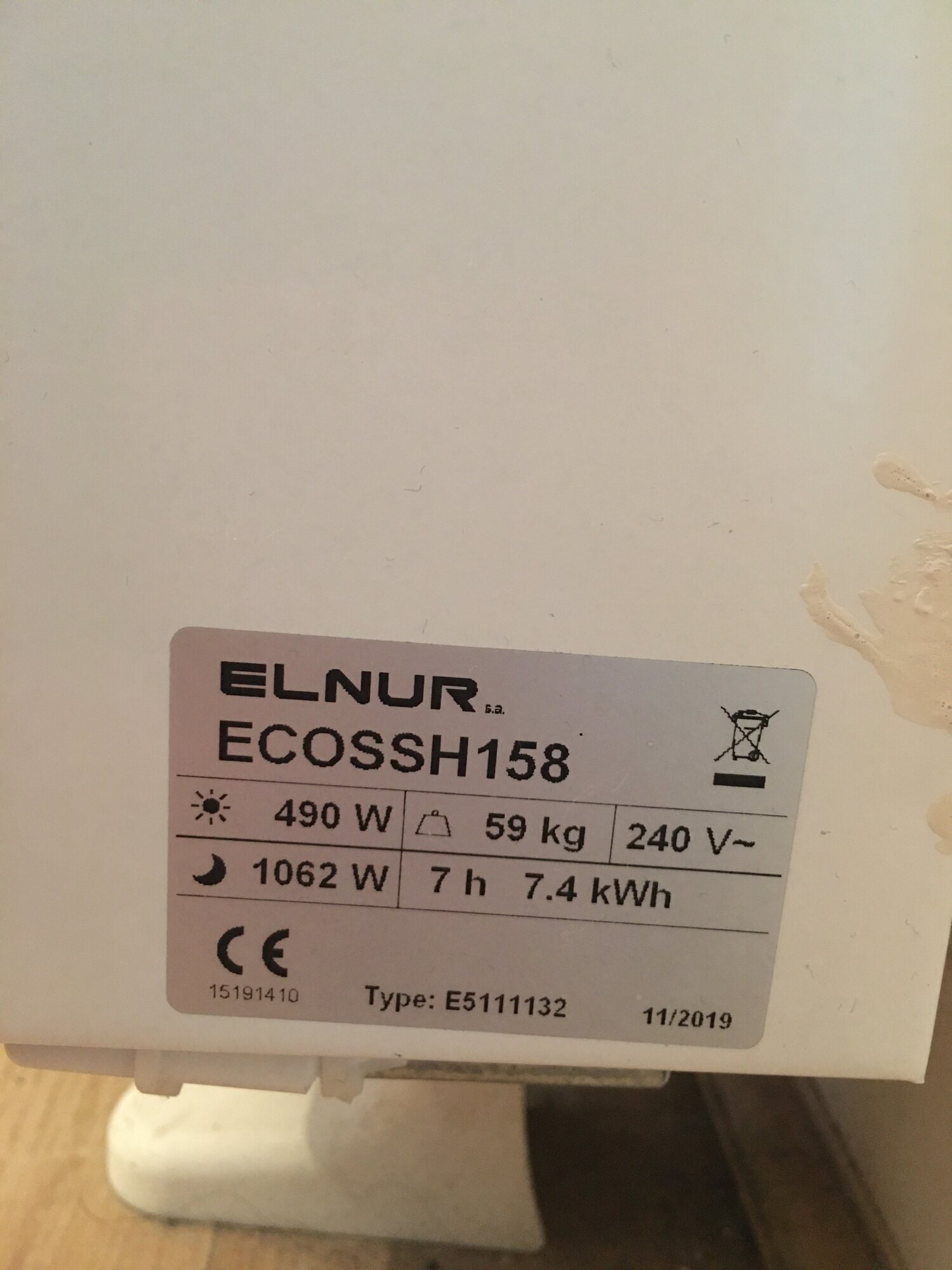

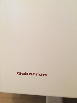

Could you tell me the make and model number of the storage heater? If you have been left instructions it should be on them, otherwise there should be a label or rating plate on the heater.
In your photo I can see a name on the bottom left of the heater, but can't make it out!
Is it an Elnur Ecombi SSH?[ElectriciansForums.net] Newbies in UK and storage heaters, off peak, all stuff
Is it an Elnur Ecombi SSH?View attachment 93420

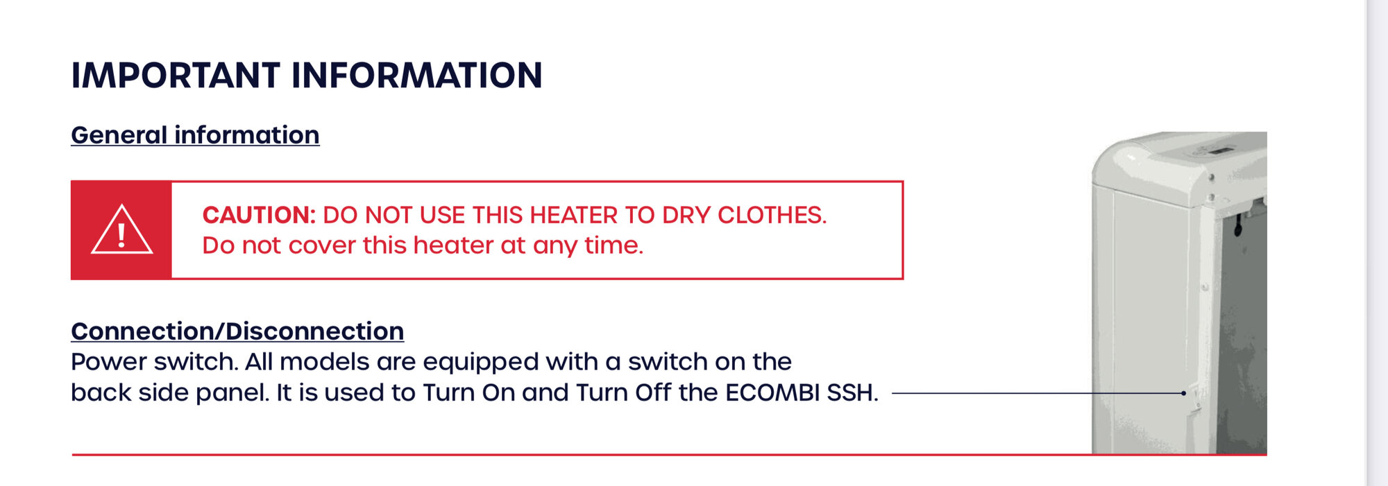

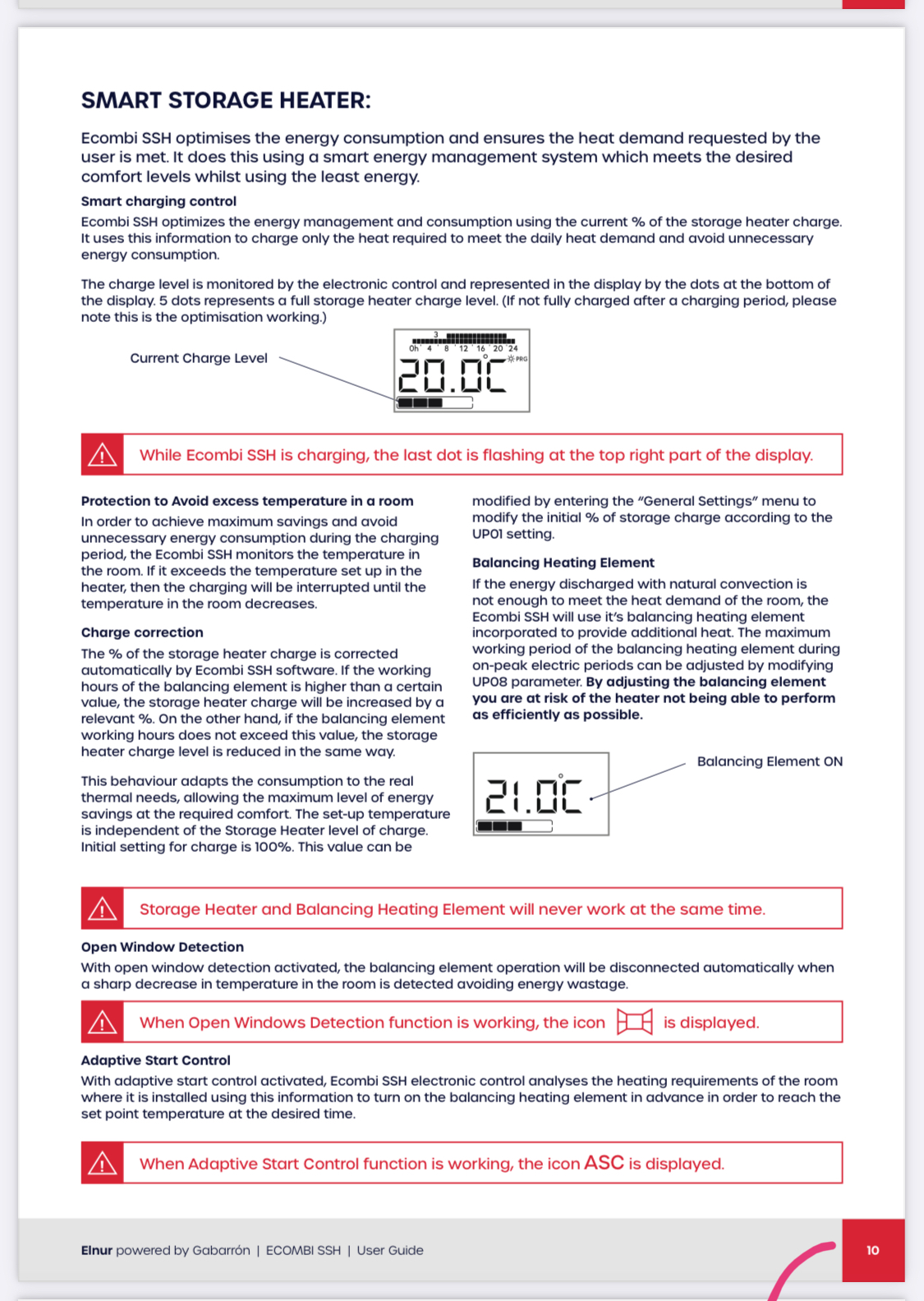

Ok, I have the manual, and we have seen that the manual had instructions that the Storage Heater doesn't have (parameters, configurations, that doesn't appear in our devices). We have two little Ecombi SSH158 and one bigger Ecombi SSH308.

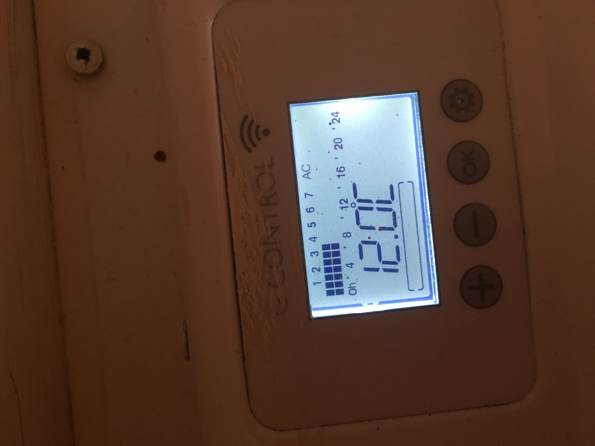

I found the page about charging (attached photo). I don't know if this is correct.... I have to use the storage heater at a comfort temperature, so the software will determinate how many charge will need the next day? If I don't use it, it will not charge?
Also, the parameter UP01 (initial % of storage charge) it is actually 100%, but the storage heater doesn’t have charge. Maybe I should change it to 0%?

I think there is a misunderstanding over programming the heaters. For example I believe the 24 hour 'bar' dots represent when you want warmth to come out of the heater, comfort temp or economy temp, so you need at least one row of dots over all 24 hours, otherwise according to the newer instructions I have, the heater goes into 'frost protection' mode and does not charge at all.
There are only dots showing for the off-peak time. That's not right. The off-peak time is set in the parameters.
I suggest a good read of your instructions. Yours seem to be an earlier version of what I've found.
And could you confirm - you do have the 'on-peak' wall switch ON at all times?
It's worth considering doing a 'factory reset' to the controllers, as I think the default off-peak times match your supply, and that might get the heaters working well enough for you.

Actually, the dots point out the hours and days of the weekly charge period. The manual had configurations that our Ecombi doesn't have, like programming mode, when we press follow the instructions we only have Func., Time Settings, and Parameters Menu.
And in Parameter Menu we haven't all parameters as the manual.
