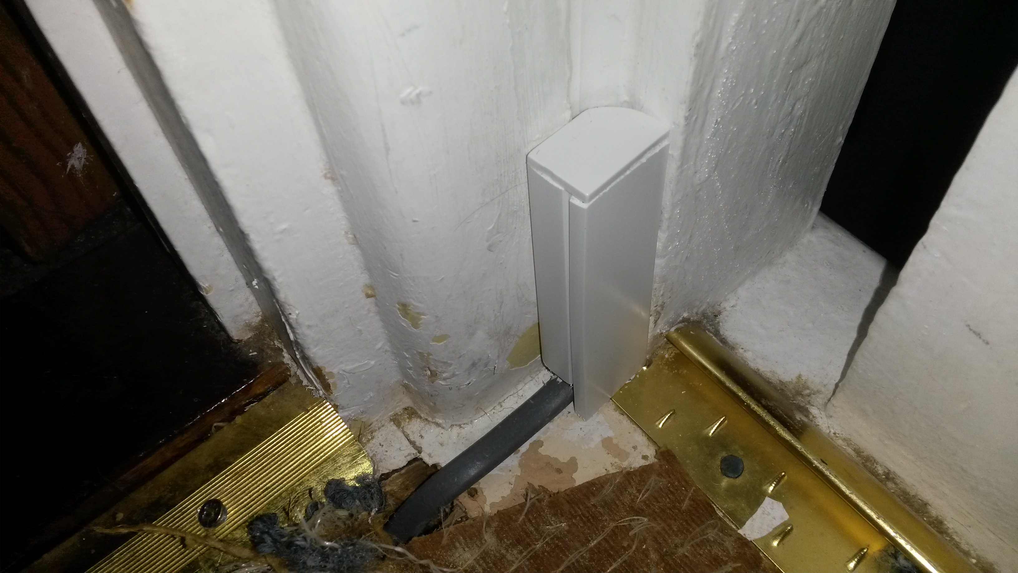

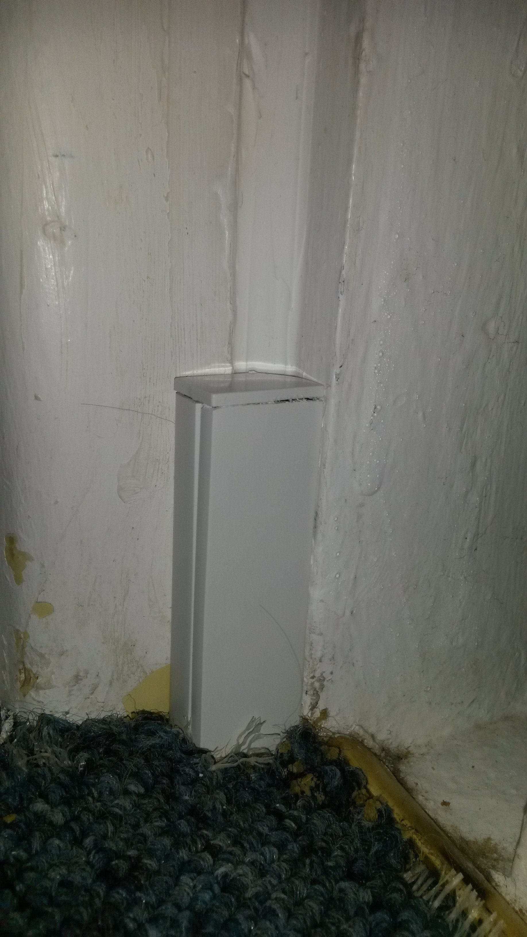

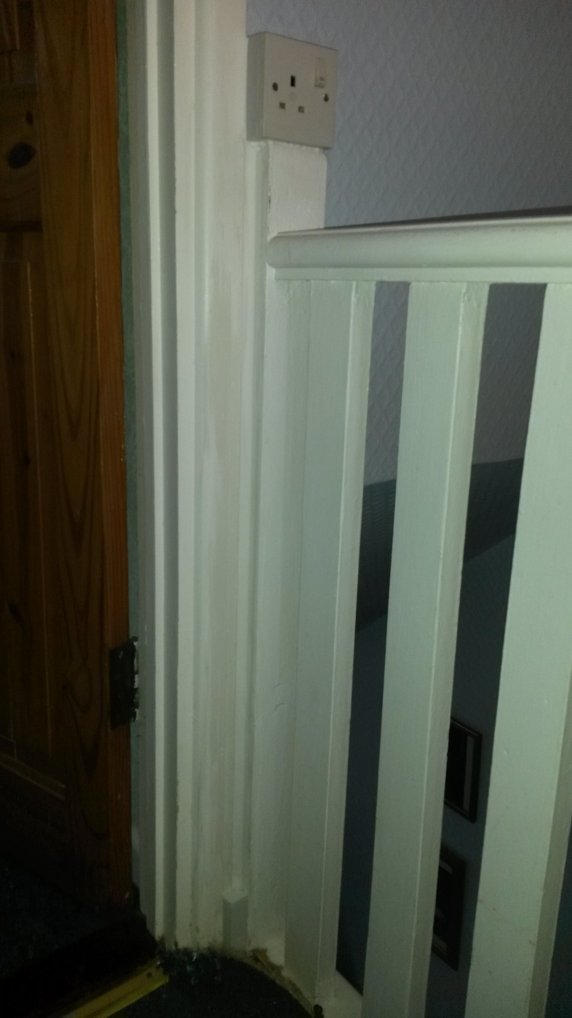

Hi I am new of this forum, sorry my English is not great.
I don't know nothing about electrical, I just moved to my new council house 4 weeks ago, upstairs in the hall it did not have any socket so I contact council asked to fit a socket for my Ebac dehumidifier 3850e it runs on 230v 13amps 200watts per hour. I only use in the daytime at the winter time only it come on and off auto if there any damp in the air.
I was not satisfied when the first council man finish the job mind look stupid but he said the steel beam that support the house was in the way he could not do straight wiring down so he moved one inch further with hole go under the carpet.
So I contact council again and complain. They send the second different council man to come have a look he said that is fine nothing to worry about it.
I want like you all have look photos to think if this is ok?
The cable print out 6242Y Twin & Earth Cable 1mm² x 10m 300-500v is this right one for the dehumidifier 3850e it runs on 230v 13amps 200watts per hour
I am bit worry because I hear not allow to have wire under the carpet may cause a fire. I am waiting to hear from you.

That's a bit of a rough old job there mate
looking at the last pic., that is totally unacceptable. the cable should have gone straight under the floor from the trunking, even if it meant cutting the floor and repairing after. surely there must ave been a better position for the socket anyway.
Can you confirm the cable size is 1.0mm not 1.5mm?
And where is the other end connected to?
