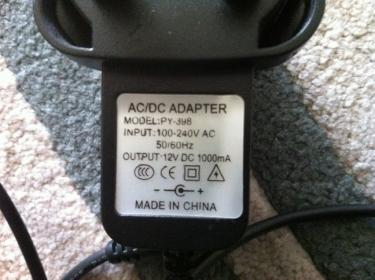

So here's the photos for the transformer:
[ElectriciansForums.net] Off Grid pv system abroad ideas/help/reassurance required!
It is DC..
Took a few more measurements today:
if i dont have any load, the voltage on the output is 38V,
When i connect the light, this drops down to 24V...
So is the light actually drawing 14V?
Also here is the other 12V adaptor i tried:
This is 12v with no load, and both have the same polarity.
